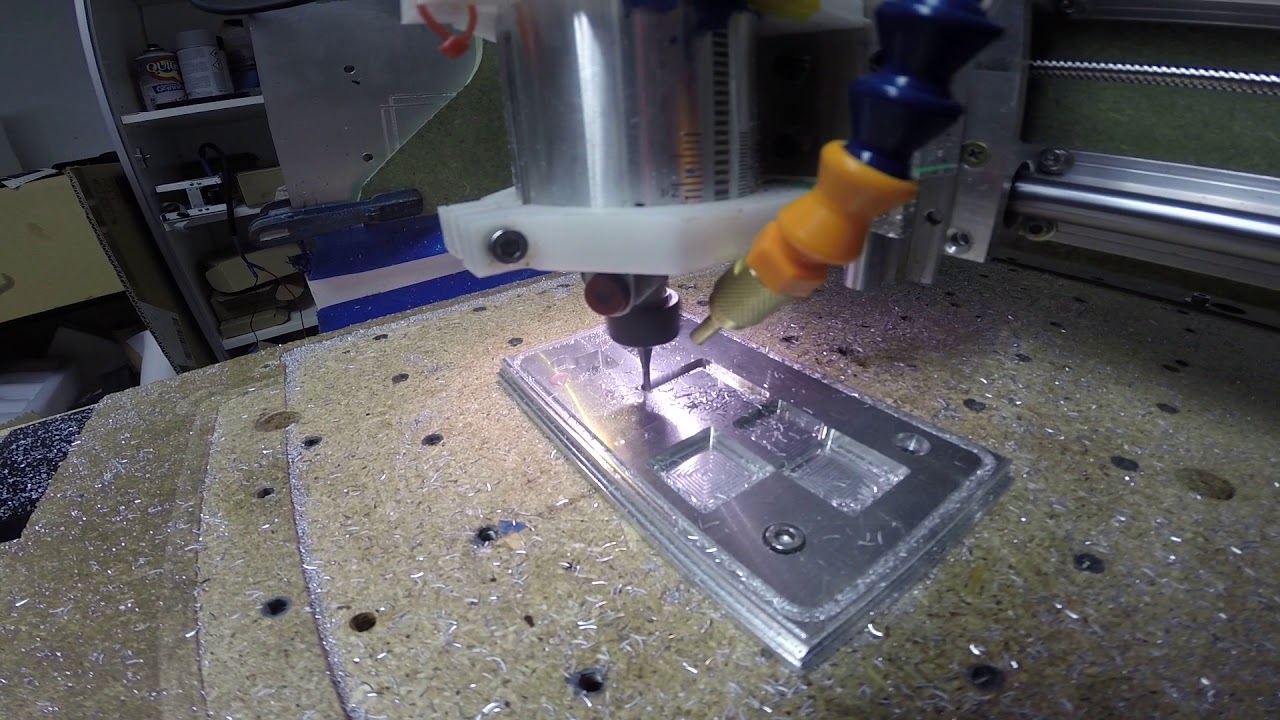

First test complete bit no time to analyse tonight. My rig managed to complete the full carve with no lost steps or any malfunction in that regard. The gantry is showing its weakness (3/4" MDF) during the more aggressive cuts with skewed sidewall of the pockets.

This image show with highlights where the sides started to become skewed, highlighted in red.
The rails the gantry rest/move on is also oriented in a way that allows the side plates to “rotate”
For CNC rev.3 this will be improved among other things I have learned since the beginning.
However, I ran it quite hard during this test, WoC=0,8mm @ 600mm/min so I might dial WoC down a little bit and see how it may act differently. Running a similar test again, but with a fixed pocket depth and variable WoC might provide me with even more data :slight_smile:
Due to rough running/chatter I increased RPM to about 13-14k which smoothed things out a little bit.
BTW - the complete carve, 8 pockets, took 12minutes :slight_smile:
Nice big chips! The alu. block was luke warm to the touch after completed cycle.
Denatured alcohol used btw with a mister.

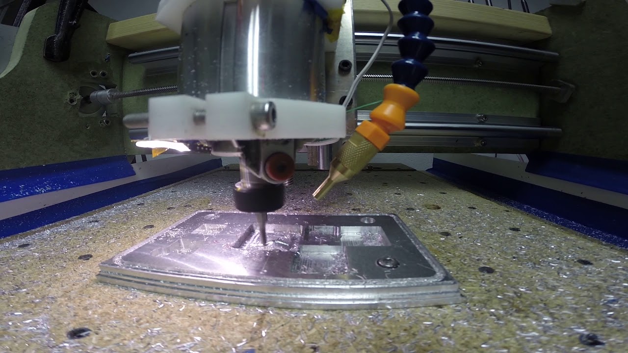

After not being able to carve much for a while I finally had some time to test some changed GRBL-settings, specifically acceleration. Also shown is the mister.
Pocket 16x16x4mm drawn in Easel, nothing fancy.
Max move rate (G0)
XY=5000mm/min
Z = 3000mm/min
Accelleration (GRBL) for XY = 500 and for Z = 750
Cutting parameters:
Feed rate 1800mm/min (70,8IPM)
Plunge rate 100mm/min (4IPM)
Depth per cut 0,2mm (0.008")
I like how the top of the gantry serves as a bit holder :slight_smile:
I really haven’t played with the plunge numbers except keeping them on the low side.
