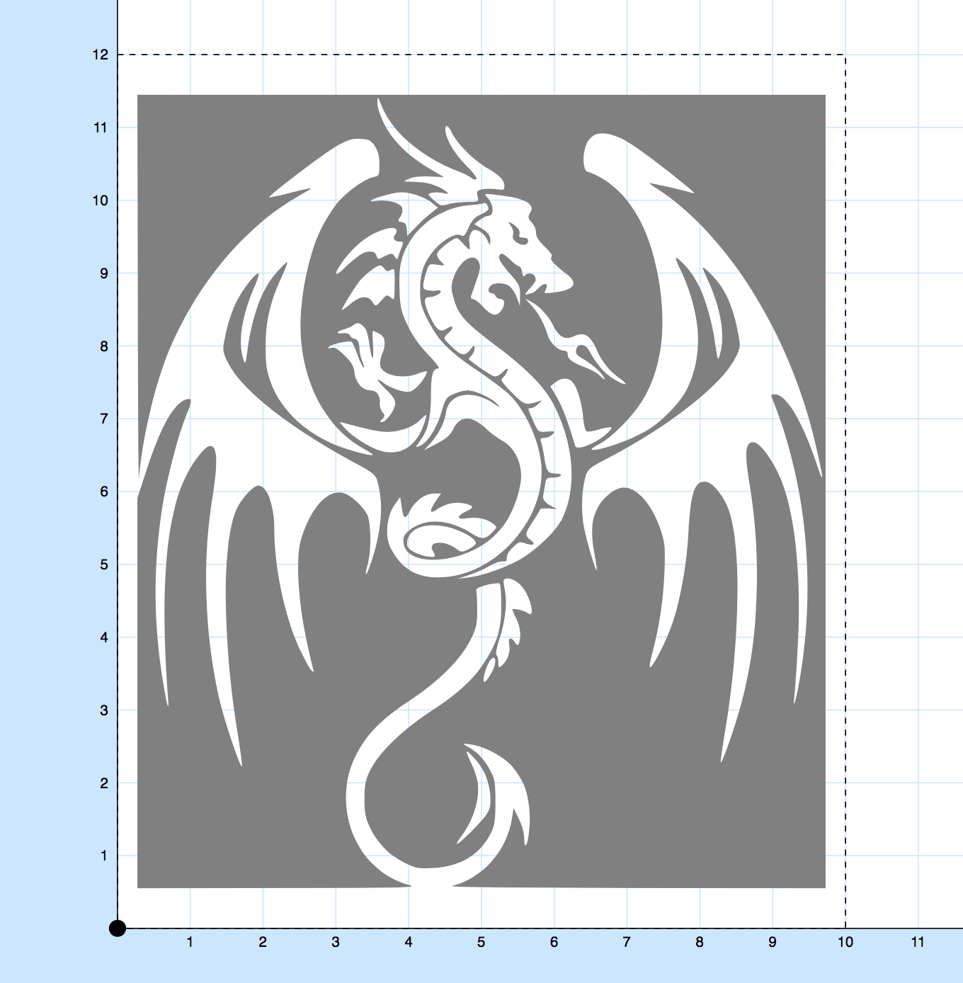

While I’m awaiting the arrival of my XController, I’m slowly building my project list of items I want to carve. I created the following carving and shared it so you can look. What I want to know is…how would a multi-carve project operate? Would the XC carve everything with the larger bit first, then stop for me to change the bit? If so, do you just click the carve button after you change to the smaller bit for the finer detail work?
Yes.
When you setup a multi-stage carve, you’ll be prompted when you click on “Carve” and select which cut (Roughing or Detail) you want to carve. Because of the way they changed the toolpaths, you want to run the roughing pass (larger bit) first and then run the detail pass with the smaller bit.
When changing the bit, you have to be extra careful to not move the carriage in the X and Y direction (the motors should be locked) so that your X and Y zero location doesn’t change and then you’ll reset your Z for the new bit either manually or by probing.
Does this make sense?
That’s perfect. Thank you. I wish Easel would offer a third bit, I’d like to go with an even larger roughing but so the entire carve wouldn’t take so long.
