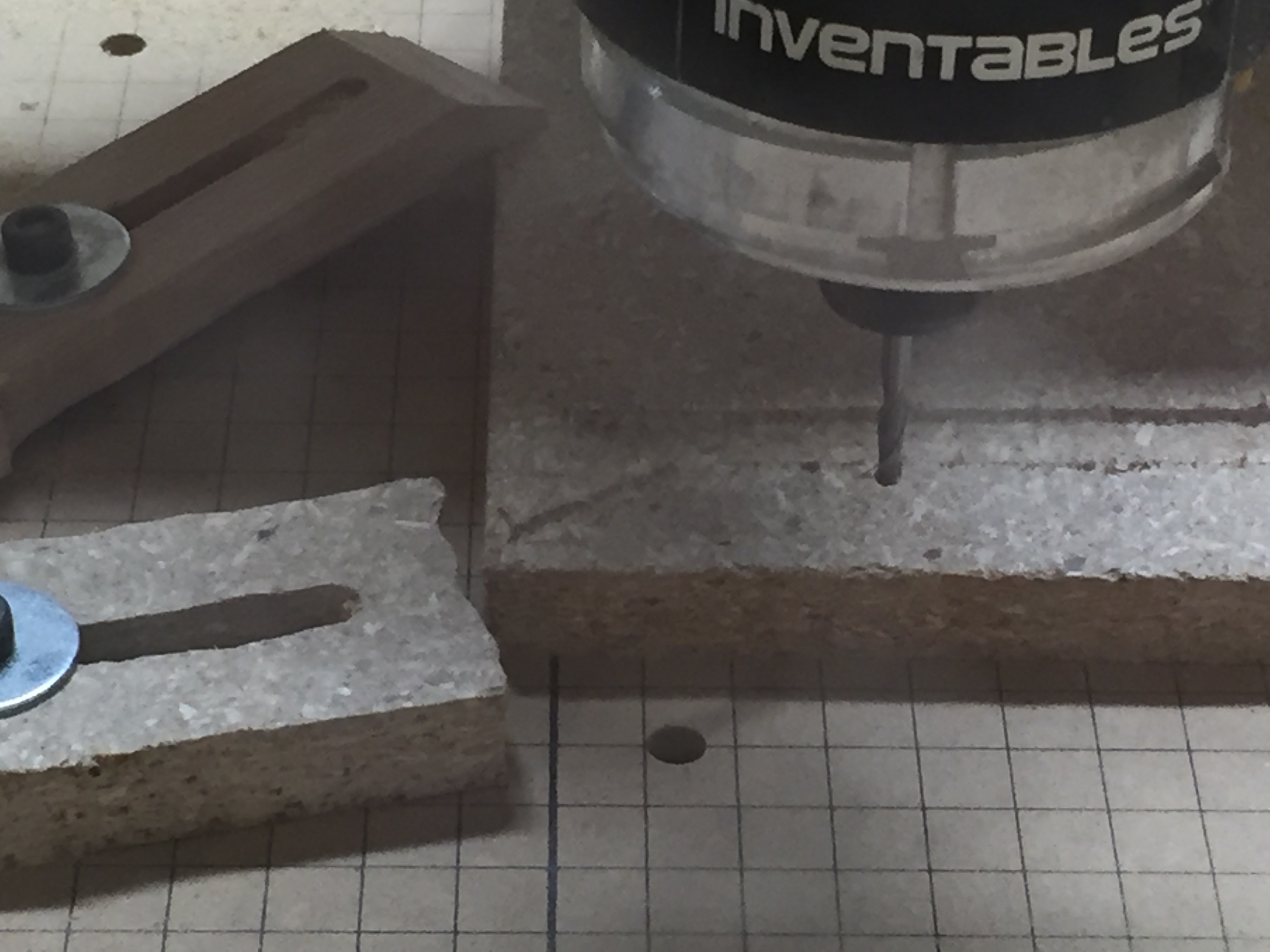

Here is my setup:
Here a screenshot before I hit SEND:
And here is it after the first few minutes:
Not sure if the jerky stuttery movement is from the software, but i almost doubt its from the machine because i was able to cut through the same MDF with the DEWALT and the 0.125 carbide ball mill in way bigger chunks than i did here.
So while this was better than the first try, i still need to figure out:
The movement you are seeing may be caused by all the small vectors you have in the gcode, instead of smooth arcs it is making lots and lots of small vector movements and the result is the “jerking” motion you see. Just a guess.
Also you’re trying to cut particle board. Lots of gunky stuff in it. If you have little bit loose belt, this will happen. MDF is the easiest material you can cut. If you want to see if there is something wrong with your setup, particle board is good challenge. Like Allen says, vectors makes jerks but if this jerk comes from vectors, you must be able to see stepper movements in same time. If these jerks more likely shakes, I suggest you to take belts more seriously.

I just ran that job and it went well. I saw that the jerking move is only on the X axis when it goes to the left, moving right is buttery smooth. I thought it might be because it takes a deeper bite out of the wood moving left, but when i looked at it from the side it looks the same. So maybe it is from a different stepping on left movements than on the right ones.
I also set my safe height this time and after i cancelled the job it raised Z first:
It returned to a little bit left of my original set 0 0 0 but thats maybe because i cancelled the job and it didnt know exaclty where it currently is?
OR it lost some steps inbetween which could be since it seemed like the whole carving was skewed to the left, like it was approaching the left side of the material the more it carved away on Y.
If that’s the case i need to find out WHY its loosing the steps, it might have to do with the jerky movement.

I just started another try, but I still have the issue that the X axis stutters on the way back to the right, left is always fine.
Really not sure why that would be… I added a link to a video to this post.
Its hard to see because I think the phone camera tries to correct for the stuttering, but look at the power cable from the DEWALT, or listen to the audio and you can hear that stutter.

Can you reduce the amount of bit extending from the collet. The shorter the better.
Oliver,
To try and narrow that down a bit, can you swap the X and Y stepper wiring at the gshield. If it is a driver issue, the stutter should transfer to the Y axis stepper. It doesn’t seem likely to me that short moves would only cause a stutter in one direction and not the other, but I suppose it might be possible. Sorry, but I can not review the video as I do not have Flash player installed.
John
@AllenMassey I couldnt make it shorter because the stock was around 1 inch thick
@JohnChamplain I tried another job via Easel and it does not seem to have the issue there.
If other jobs don’t have the same issue then it is more likely that the small vectors are causing it.
Also, If your overlap is set incorrectly then it it is possible that moving in one direction is taking out more material than the other direction.
FYI, grbl does not support arcs.
Oliver, if the same gcode file, I can’t understand how any sender can cause a one-way stutter. Can you run the file cutting air with the spindle off to see if the stutter disappears? Allen’s diagnose may be correct.
