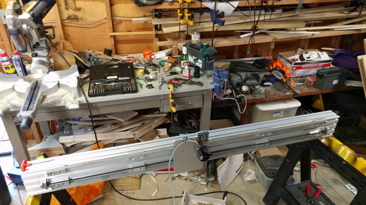

Working on massive X axis upgrade …
Wow, what a beast! Are you planning on using larger motors to push that thing around?
Yes you see the motors in the background dual shaft 4.0A 400oz.in. I already installed them in existing gantry and they work great.

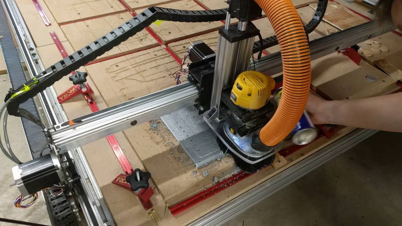

Rainy weekend so I had a chance to do some alu milling of plates for new axis.
Nice and slow but it took less than an hour anyways to cut. Very precise cut and I could not ask for any more,
I think its a true testament to my method of tensioning belts.

Where did you find the 160 X 80 ?
I’m using 3060
But they also carry 8016
https://8020.net/shop/40-8016.html
Ah. Thanks
Took me a week to figure out belt tension at 90 degree angle in relation to extrusion, 9 wood prototypes later I ended up with this:

Oh yeah and another Alu cutting video …
More progress this weekend.
holy ****!
This is beautiful. My kind of project. Those belt tensioners are industrial!
Wow what a sturdy beast.
What size is that aluminium extrusion 80x160, or even bigger maybe?
Edit - I see I missed this info in an earlier post
Baby DeWalt , feels so insignificant …
It does look rather diminutive on that monstrosity. Kinda like a body builder on stage and… er …um…:sweat_smile:
