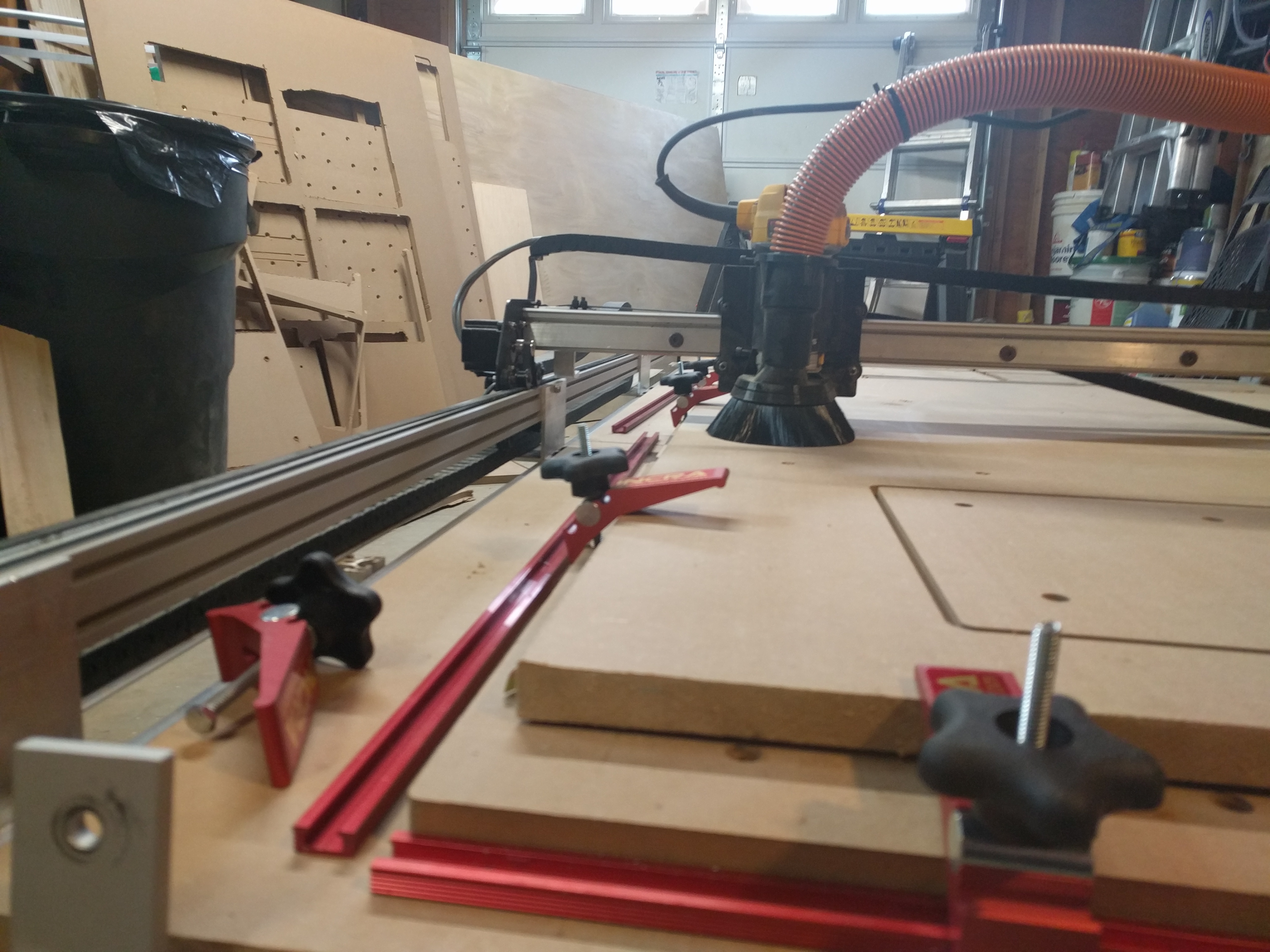

Did some more work this weekend. Some issues came up but nothing I can’t correct so far. Sadly I got to replace one pulley as it slid off a bit and I can’t remove it for some reason. I hope I don’t destroy the motor in the process !
Hold-downs stand so high sadly it looks like I will have to trim or replace the bolts or I will ram my X axis into them. I got to say it was a lot of fun to drill 3 counter sink holes into 12 inch sections of rail using regular bits, not something I’m looking forward to do again anytime soon. Another thing I had to change was the nylon screws for “armor plates”, overall I did not feel like they felts strong enough and I broke few of them while installing, decided to use regular screws and I hope not to ram any of my bits into them.
In other news, the lift that folds the table still works but makes me nervous like hell ! this thing is so insanely heavy it would kill whatever walks under it if it snaps. I keep thinking of adding some more bracing to wall all around to make me feel more comfortable around the monster.
Per usual some more pictures of the build, I hope someone gets some out of it…
I almost forgot … just for kicks while working on few more MDF plates I decided to push things a bit. Video of cut at 200 in/min at .15in pass with 1/4 burr bit.
It did fine and looks like it can go even faster when I actually calibrate and level the monster.

I will skip the cost of folding mechanism as this is very much depends on your setup. I will also skip all optional upgrades like 9mm belting, stiffening and x controller and my choice of hold downs.
Have reliable way of cutting aluminum and rig to drill straight holes (miter saw and drill press)
6mm belting feels inadequate, search forums for 9mm parts list to upgrade, I also added bolts on both sides of each makerslide for tension as it is much more work to do it on such long distances.
I had issues with L shape alu clearing my side hold downs bolt after debating different complicated builds my neuron network fired up and I replaced whole support system with 2 strategic cable ties lol

To answer your question what it can do vs cncrouterparts kit? Their kit will be superior in every single aspect except price that is beyond any doubt or speculation lol
Took months of work and I have to admit I enjoyed building CNC as much as I enjoy cutting things with it. I wish I had enough disposable income to keep building different ones.
Overall I consider the project great success as it hit all the marks I was aiming for. That includes precision, cost, speed and few other secondary factors like ability to fold it away If I need to use my garage for anything else.
