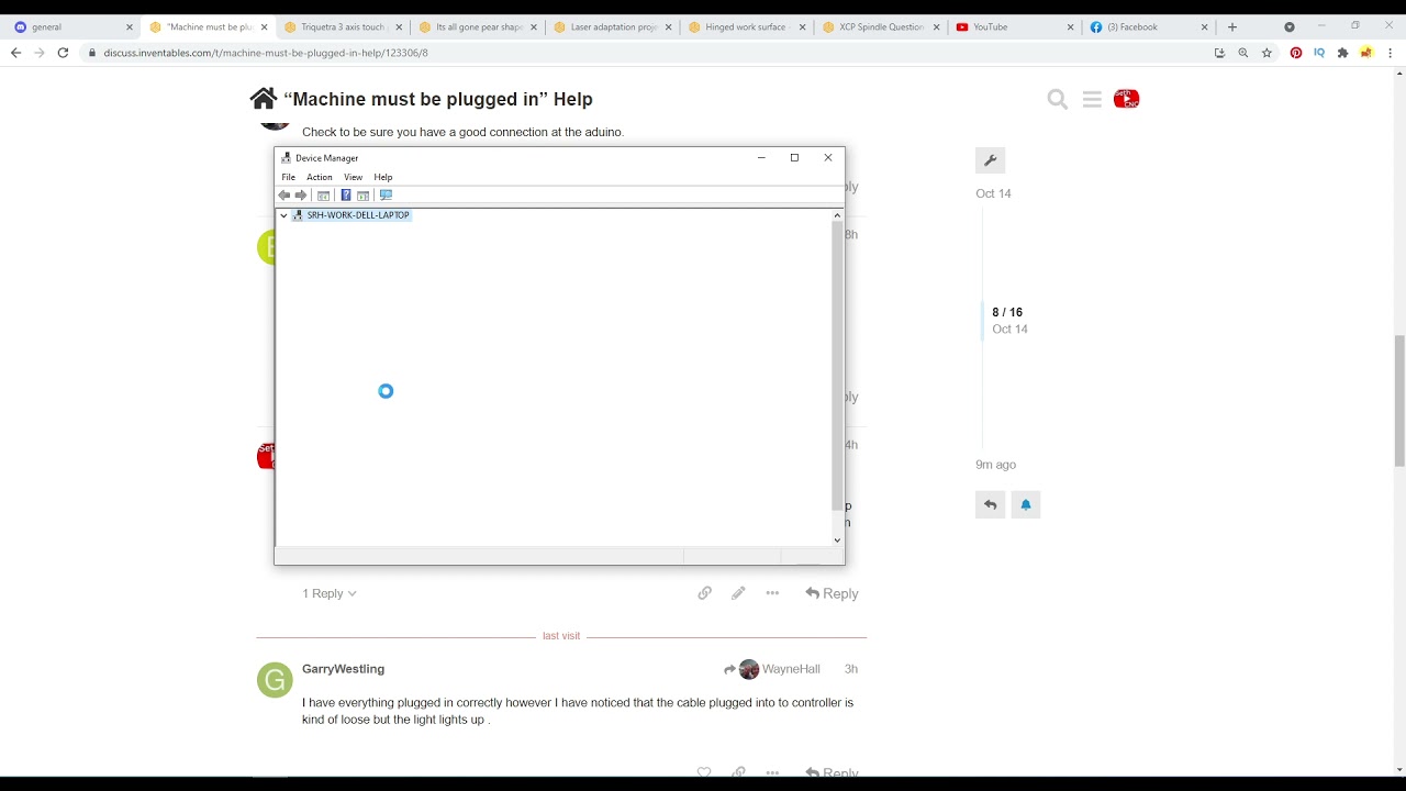

You can go into device manager and expand the tree labeled PORTS and should see the com port pop up when the usb is connected and dissappear when disconnected. If this works properly, can you open the properties and take a photo and share that…
I have everything plugged in correctly however I have noticed that the cable plugged into to controller is kind of loose but the light lights up .
I have tried all of the above suggestions and nothing works. I am bald so I don’t have any hair to pull out and I don’t drink. Now what?
I went to Device Manager but could not locate a tree labeled PORTS. I am using Windows 11 if that makes a difference.

Wondering if it needs to update a driver… We’re sure there’s power to the machine? Connections are all tight? We already restarted the computer and tried a different USB port…

This is probably a shot in the dark but unplug your usb cable from the computor then restart the computor. If it is fired up open Easel up. After Easel opens then plug your usb cable in and see if that helps.
Thanbk you Wayne for the great video. I will attempt to follow all the suggestions . The fan turns on when I turn the machine on. When I plug the USB cord in, a red light in the controller turns on. Sometime today I am going to play some more with it.
