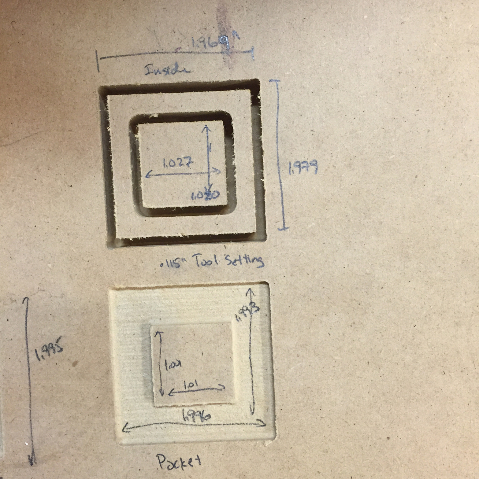

Latest round of testing and even more confusion. I did a couple of different preliminary test cuts, ultimately finishing with a 1" square centered in a 2" square. Had two copies of that configuration and cut one as a pocket toolpath (pocketed the gap between the squares) and one as a profile toolpath (both selected so inside the 2" and outside the 1"). All done with Vcarve. Did a test cut and found my 1/8" bit cuts a 0.125" kerf. But ended up running .115" tool settings as .125" results were too big (bigger than what I will report for the .115"). Ran the cut. With the pocket toolpath, the inner squares outer dimensions were 1.01"x1.001" (x by y) and the outer squares inner dimensions were 1.996" x 1.993". With the profile toolpath, the inner squares outer dimensions were 1.027" x 1.020" and the outer squares inside dimesions were 1.969" x 1.979". First, is not the only difference between pocket and profile the fact that the gap in between is cleaned out? Second, should not the inside and outside squares outside and inside toolpath have been the same and thus the same dimensions??? So confused. Trying to upload a picture, will see it works.
[Uploading Cut.png…]

I think I mentioned earlier, that yes, the gcode run with a vbit and tool path ON the line is dead on accurate, which makes this other more puzzling. Assuming the pocket and profile paths are also accuate, 1) why are they different like shown in the picture. Even if the tool size was off, should not both pairs of squares be off the same? and 2) what else could it be??? I have calibrated, checked and tensioned belts, checked and adjusted pots, squared everything, and made sure all the vwheel are not free spinning or too tight. Surely there is something simple I am missing but after a week of trying to figure it out, I am out of ideas. Not being able to get accurate pocket and profile cuts pretty much kills this thing for the projects I have in mind.
I just wanted to point out that vCarve is putting the center of the tool exactly where you are asking it to be.
Tell vCarve that you are using your .125 end mill but actually load the vbit and do the shallow cut so you can see exactly where the tool center is positioned for the cut.
If you asked Vcarve to do an outside profile then the center of the tool should be exactly .0625 outside of the boundary of the square so measuring side to side on the thin tool center line should be 2.125 inches apart for a 2 inch square.
If that distance is exactly 2,125 then you will know that the problem lays with the bit you are using.

Let me guess. The outside square you were machining in a counter clockwise direction, right.
If that is the case you can see the problem in the photo. Look at the 4 corners. Do you see what looks like over run of the end mill. That is not over run that is the end mill cutting where it is suppose to. Then when it starts to cut the next side the end mill is deflecting to the inside of the square and cutting under size.
I’ll also bet you are cutting the inside square in a clock wise direction. The deflection is now away from the inside square so it is over size.
If your software will let you do a roughing cut that leaves .01" material on the square. Machine in a conventional direction. Then do a finish pass and remove that .01" using climb milling. Now measure the results and see what you get.

I did some tests cuts like before and measured the width of the toolpath, as well as the inside and outside edges for a difference to determine an accurate cut width and over maybe a dozen measurements get a 0.127" cut. Used that for the same test as earlier with slower cuts and am getting a 0.95x0.97" inner square and 2.025x2.02" inner square (the top profile cutout like in the earlier image) and a 1.02x1.02" inner square and 1.97x1.97" outer square (pocket toolpath like the bottom earlier image).
So, I feel like I am getting closer, but think changing actual tool cutting widths like I was doing earlier is not the way forward. This seems like it is as good as I am able to get things. My biggest concern is that I still think the error between pocket and profile should be the same (and I am pretty close), even if I am off with the toolbit cut size a bit…right?

On the profile cuts did you program a roughing cut and a finish cut. On the pocket cut I see that the tool path appears to traverse back and forth from left to right and then right to left.
Most true CAM programs will start at the outside edge of the inside square and travel around the square in ever increasing squares until it reaches the inside of the outer square. You can set this up to do conventional milling or climb milling. each have there good points and there bad points.
If a machine is set up correctly with no slop and your steps per unit of travel are correct and you have checked your machine seven ways from Sunday and appear to be right.
The one thing that can be biting you is tool deflection.
