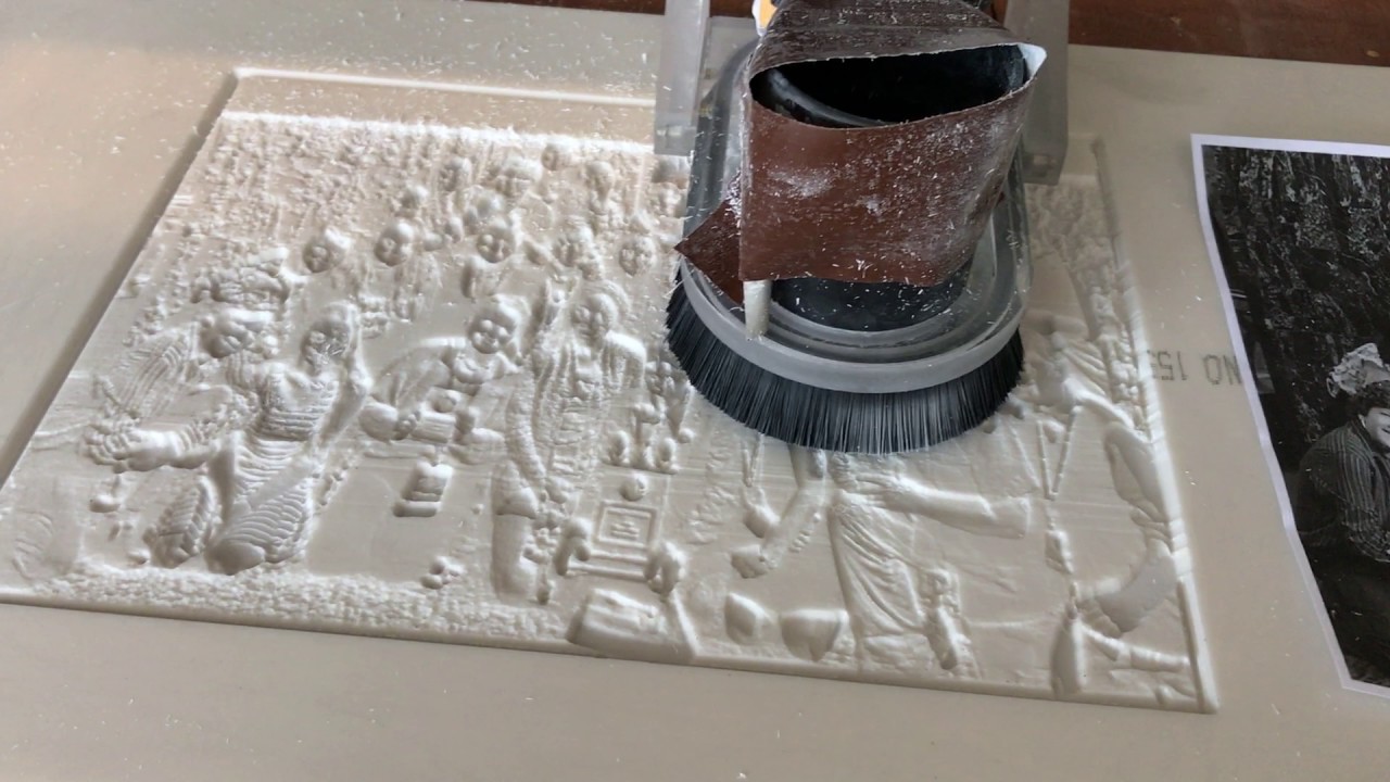

Larger project- 11"X14" litho. Overall project took about 30 hours to complete (with a failure in the middle of the project).
-Adjust picture for project-`1 hour (I am still slow with software products) Picture size was 12"X9" with 1" edging
-Failed cut -2.5 hours - had a belt break…forced to start over unfortunately
-Full cut of backside and litho- 22.5 hours
-Cutout and laser dots on acrylic for lighting - 1.5 hrs
-Set up electrical (add switch and solder connections) -0.1 hrs
-Framing- 0.1 hrs
Material used- Corian, acrylic, LED lights, power supply, switch.
