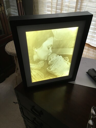

My largest lithophane to date- 11"X14" frame with the litho cut at 9"X12". Cutting out the back of the corian to bring the remaining depth to 0.20" took about two hours with the 8mm ball nose bit using Easel. I used pretty conservative numbers in the speeds and depth of cut.
The actual cutting of the face piece was with a 60-Degree/90-Degree V-Groove Double Ended Solid Carbide Router Bit 1/4-Inch Shank (YONICO Solid Carbide V Groove Router Bit 60 & 90 Degree 1/4-Inch Shank 14103q - Amazon.com). I used Picengrave Pro 5 as the software (settings in the pic).
The frame was bought at Michaels (on sale $10), (custom matting $14- not required but I wanted a bit thicker border for this picture)
I didn’t want to pay for the large Lithophane lights from Large LED Light Panels – Lithophane Lights though they make a very good product. I took a 1/8" thick clear acrylic and etched cross hatches across it with a 60 degree engraving bit (0.02" deep) and put an LED light strip around the edge, bought the plug and attached the switch.
This picture was pretty sensitive to my friend as the baby was in the hospital at the time and had the oxygen hoses across his face at the time. That can be seen in the picture so without the background info it looks like a mistake in the cut but it fit the picture pretty well.

I also added a light diffuser behind the litho and in front of the acrylic (https://www.inventables.com/technologies/light-diffuser-film-rolls)
Finally I used a thick foam to fill the open space in my large frame behind the litho and acrylic (Robot or human?)
