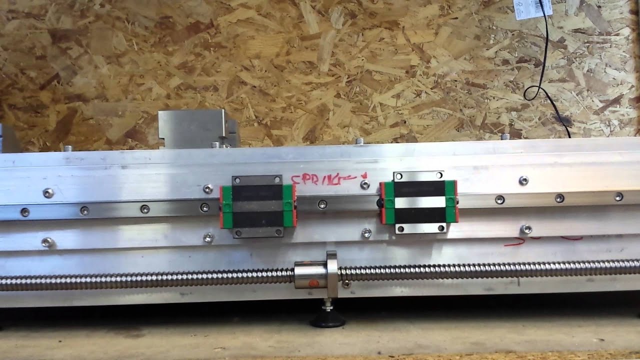

So, my 2000mm ball screw showed up yesterday, took nearly 11 days shipped. Initial inspection on a dead-flat surface shows the screw to be flat, no bowing or deflection. Ball screw nut moves freely, no binding or rough spots. :smile:
Early next week I’ll be cutting it to length for the X and running it thru the lathe \ mill to turn down both ends. One for the coupler to the Nema 23 (with flat grind) and the other end for a bearing to help with any whip.
Right now, at least as a POC, I’m going to simply cut it long enough for use with the standard 1000mm X axis, so probably 1050mm to 1070mm. Ideally I can find a source for something larger than 1000 but smaller than 2000 next time so I don’t waste any material…
The ball nut mount bracket won’t be here for another 10-12 days, which is fine, given my schedule, so I’ll either wait on it, or create a rough prototype for attachment of the ball nut to the X gantry.

Ball nut bracket showed up, now I just need to cut down the screw and mill the ends to fit the coupler and a bearing bracket. Probably wont get to that until first week of June thanks to work schedule…
All the “stuff” is here!
