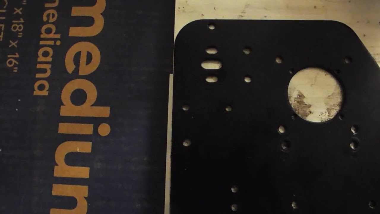

Part 2
Explaining what I plan to do in slightly more detail.
I do have experience drill holes dead on accurate. I actually happen to have footage of me here explaining this on a project that dovetails nicely with what we are doing here. Go to 34 minute mark.

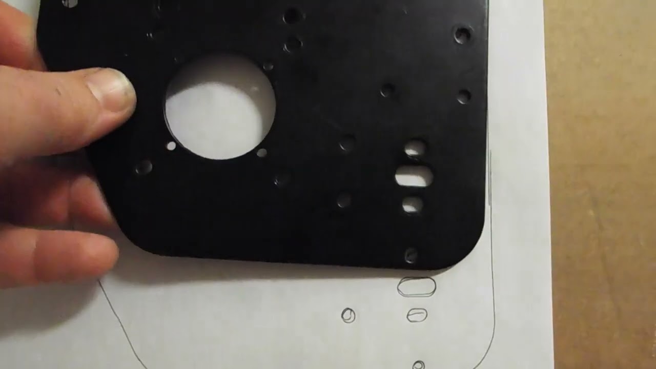

Part 3
So I have the plates cut slightly out of square and a little to small. Not a huge deal. Hey some people might benefit greatly from seeing how to deal with this. I will show how to correct for it the next video.
I cut these with an aluminum cutting blade from harbor freight. I think I spent 20 minutes or so cutting these out. Not long at all.

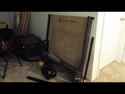

I dismantled it and am just finishing up an open builds CMC 500 x 1000
