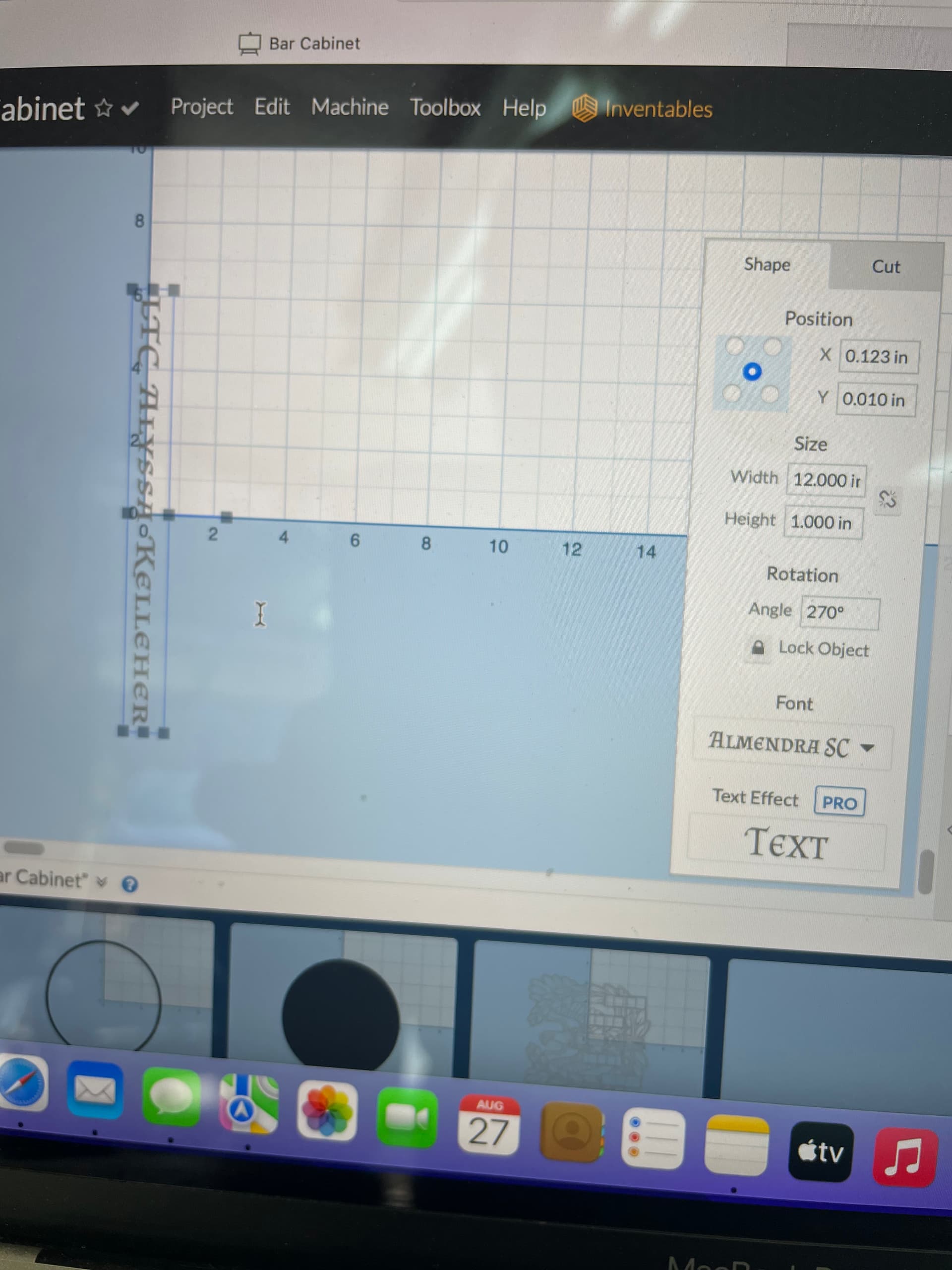

Not sure if this is me, or if something is wrong with my set up. I enter a text into Easel, and in this case I put in letter size of 1”. When it carved, it did it about “3/8”. Is there a way to make the letter size what you input?
Use the grid as a judgement of the size of the text. If you look in the picture, the outer “box” around the text is what its resizing to. You’ll notice this with several of the fonts unfortunately. Just use the corner and drag the font until its the size you want. every line on the grid is one inch
That’s kinda what I figured, but I wasn’t sure if there was a way to enter a text size of 1”, and actually have it be one inch versus gauging it on the grid sheet. Thanks!
