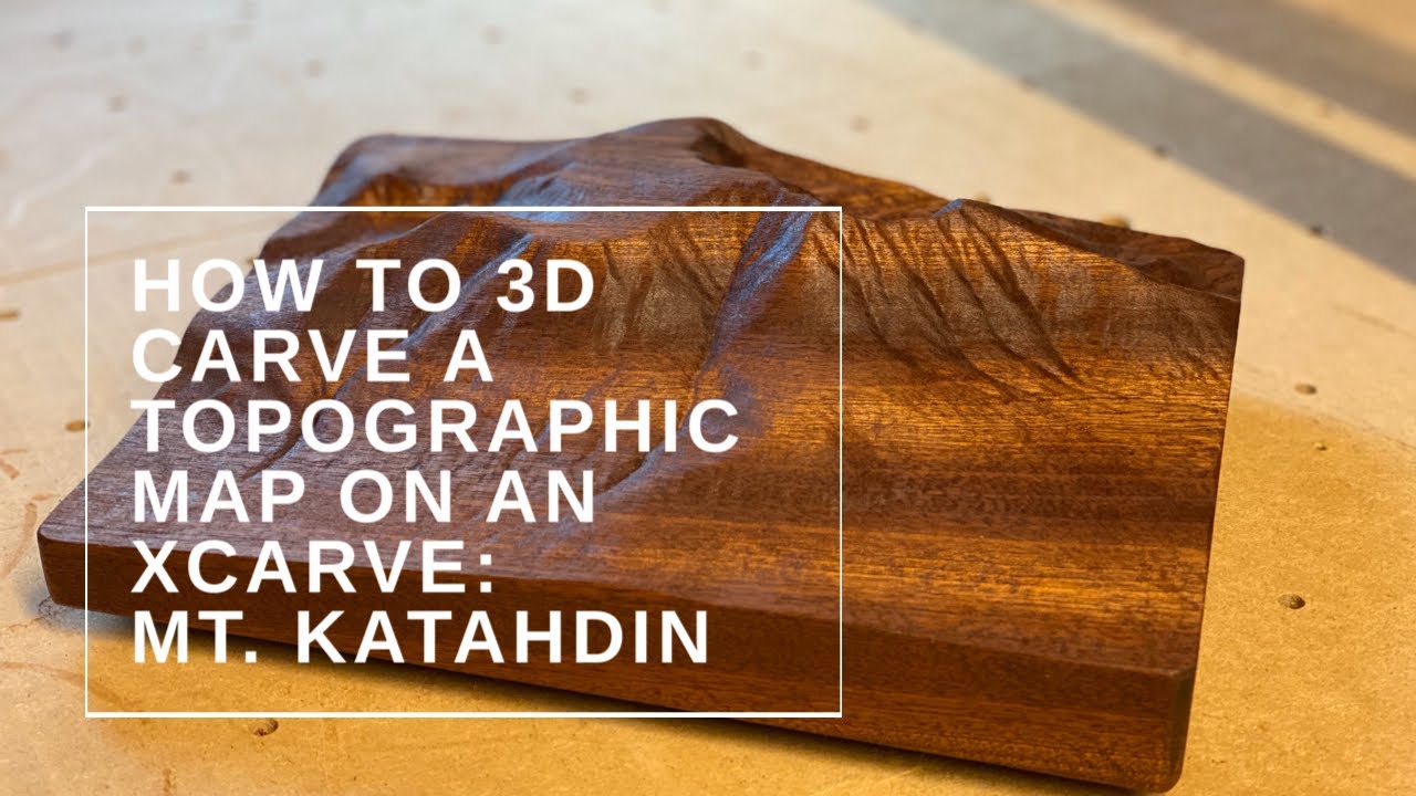

You can follow the process outlined in this video. You should be able to get exactly what you want by doing so.
You could do it manually using your file, but it would be way easier using the process outlined in the video.
