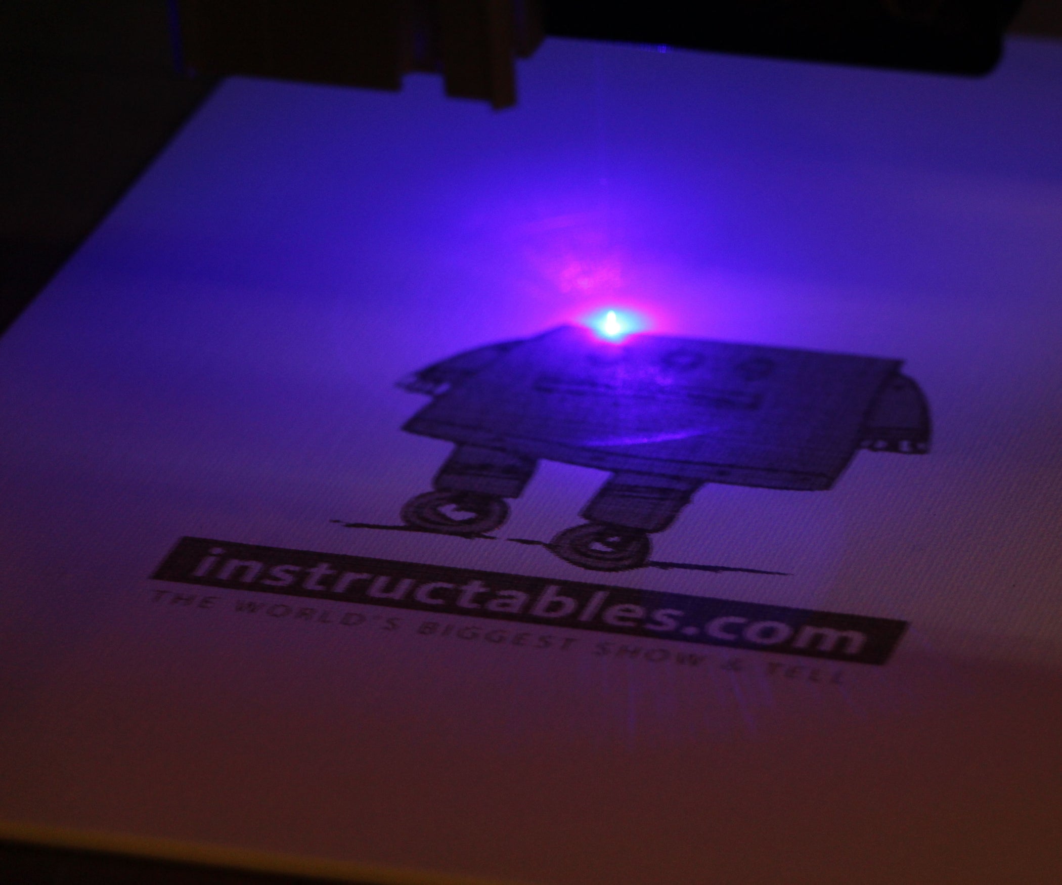

It looks like the focusing of your laser is not as good as it should be.
This looks great :slight_smile:

Make sure you have your laser safety glasses on.
We use a 3 inch focal height from the bottom of the heat sink to the top of a piece of black anodized aluminum when focusing. You may have to bump up the laser’s power slightly and rotate the lens in both directions until you see the smallest focal point possible.
After confirming the beam’s focused properly, you need to secure the lens with some hot melt glue from the lens thread to the module/heat sink. This ensures it does not move when engraving.
You need to maintain the 3 inch focal height distance when engraving on your material, or it will go out of focus.
