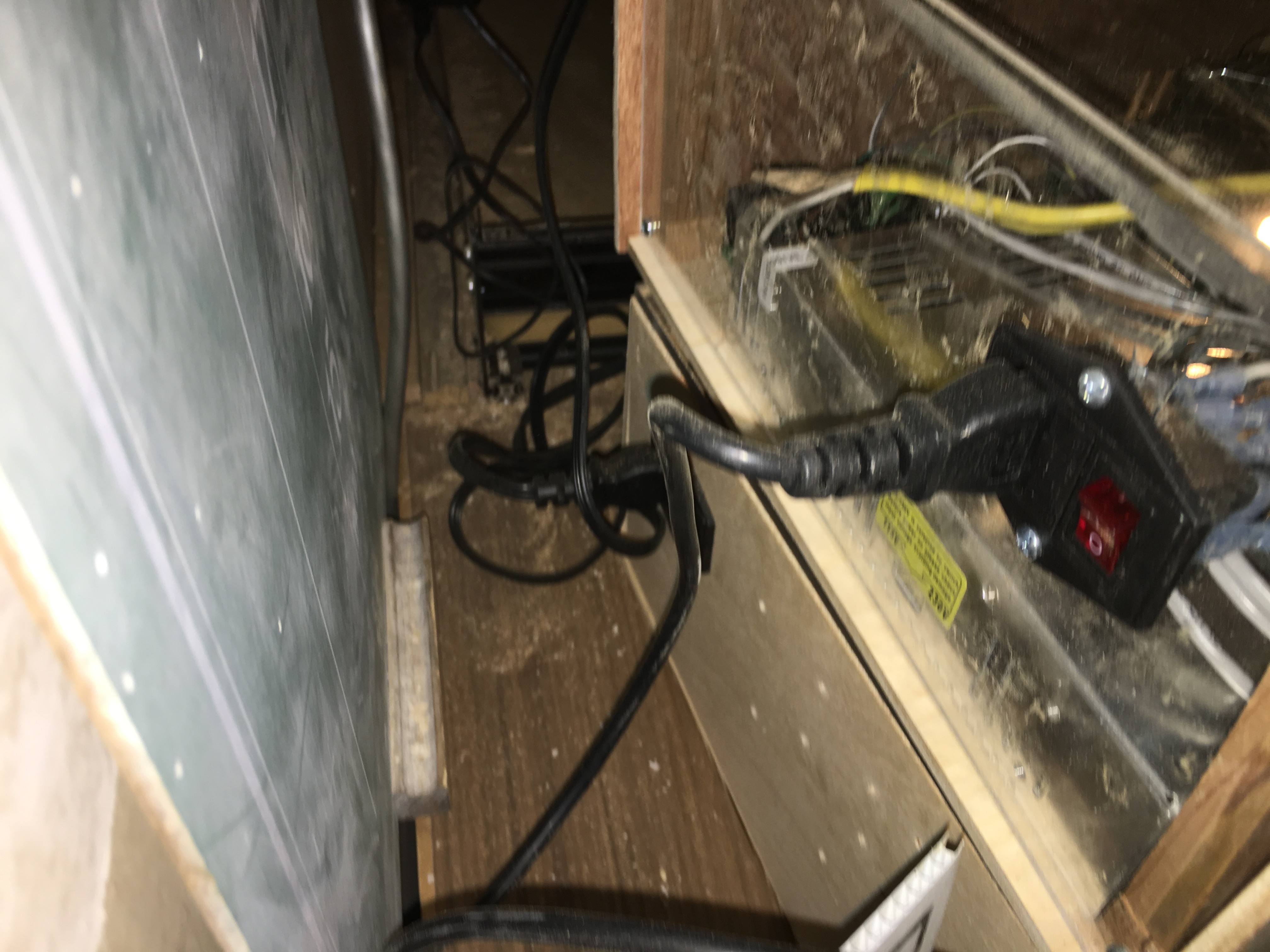

I made my own controller. Certainly no where near the quality of the X-controller. The one thing I did do was find an authentic Arduino and found it made the difference in getting the jtech 0.9g hex work. I now have two controllers - one which was the original parts from the X-carve purchase and the second with duplicate parts/pieces. The original set utilizes the latest 0.9j grbl and the other with 0.9g grbl. I just use the quick disconnects for the X, Y, and Z, as well as the USB cable. Works pretty well so far.
Again, no where near the quality of the X-controller but it was a fun build. In this case, I made two boxes as noted above- 1 for 09j grbl (spindle operations) and 1 for 09g grbl (jtech laser operations). I drew a lot of the inputs for this from this forum and I am thankful for those that posted the details. Having the two boxes works well for me. Unfortunately I spent more time on the sourcing the parts and setting up the electrical/electronics than I did in actually creating the boxes around them.
