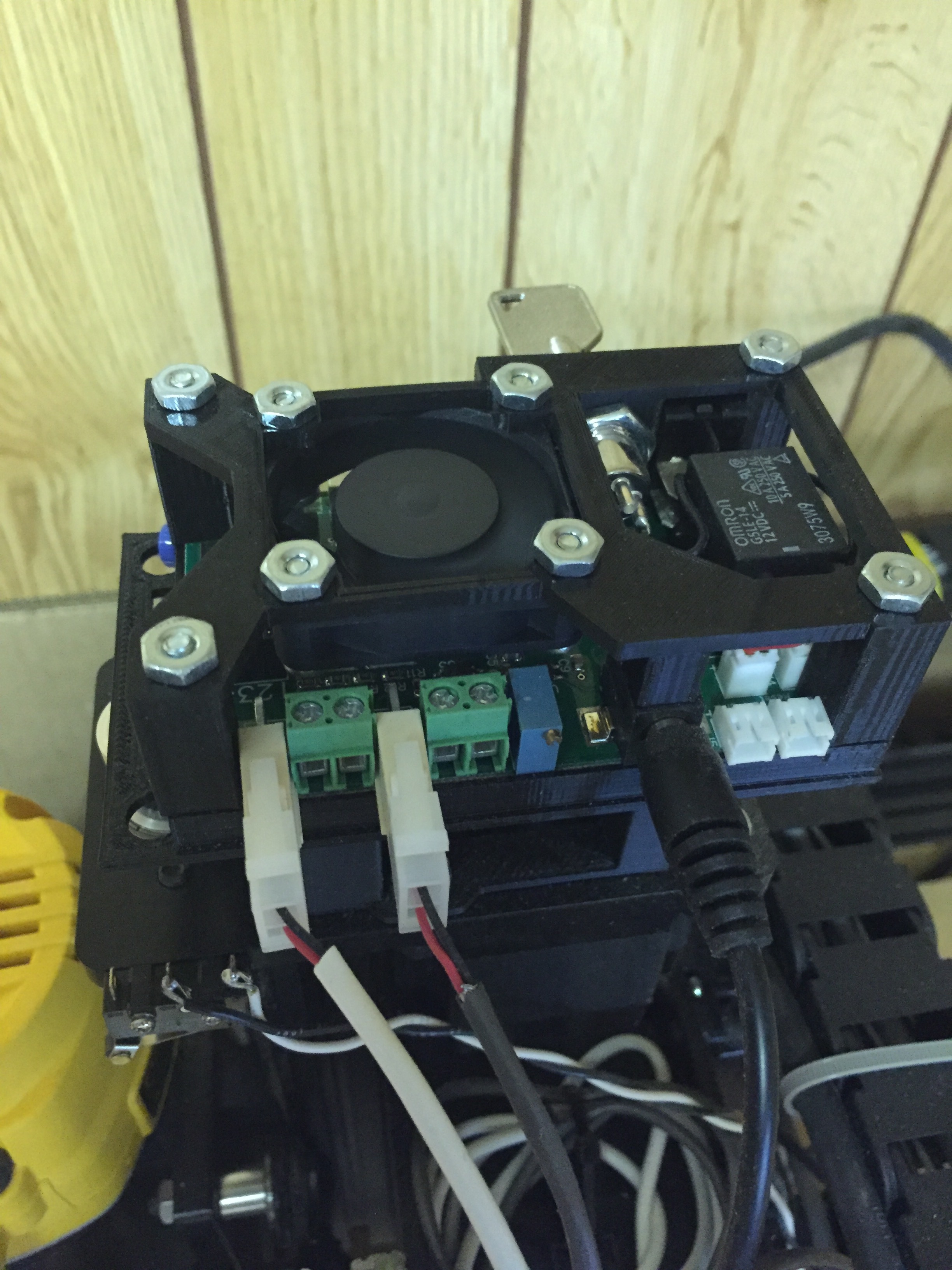

do i need a separate arduino for the laser?
Nope. The Jtech just wants power from its supply & the PWM signal from your Existing Arduino Uno that runs the X-Carve. I set up a switch bow so I just flip from LASER to SPINDLE & it sends the PWM to either Straight to the JTech laser controller or to the Motor Speed controller.
Ty Hoeffer
Palmyra, VA
do you have a photo of this by chance? im new to this and have not the slightest idea.
Do you think switching the PWM signal was necessary? Alternatively, you could have just switched power to one or the other and let the PWM run to both devicesâ inputs.
You could. I just felt it would be cleaner to be able to flip a switch & that would disable the other device while enabling the one I wanted.
Plus I figured that having both being a âloadâ on the PWM output might cause issues on signal quality.
I am interested in seeing what kind of input capacitances the PWM pin can drive reliably.
