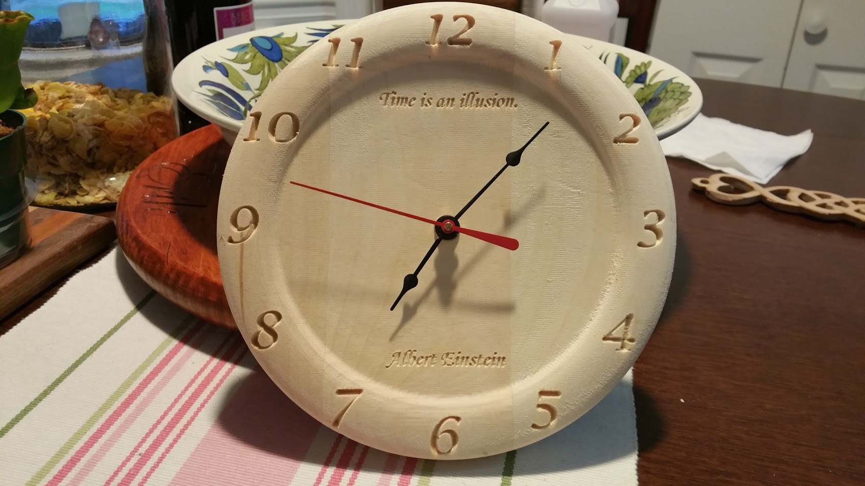

Made a quick clock as I wait for my new parts to arrive…I used a glued up aspen panel from Lowes…this is the second time I have used this panel and I am still not happy with the result (fortunately this is the last of the panel I have)…even with nice sharp bits I get a lot of fuzz. I hit the clock with a little sandpaper and did a test fit of the clock mechanism. I will take it apart and really clean it up later in the week. Not sure of the finish the clock will get…
0.25" endmill for roughing
0.25" ballnose for finishing pass
0.125" 30° v-bit for the text
what program do you use for v-carving the letters?
The face of the clock is a shallow bowl shape, aspire gives the option to project a toolpath onto the model.
I have similar works for box top lid decorations, Vcarve pro does same as well.

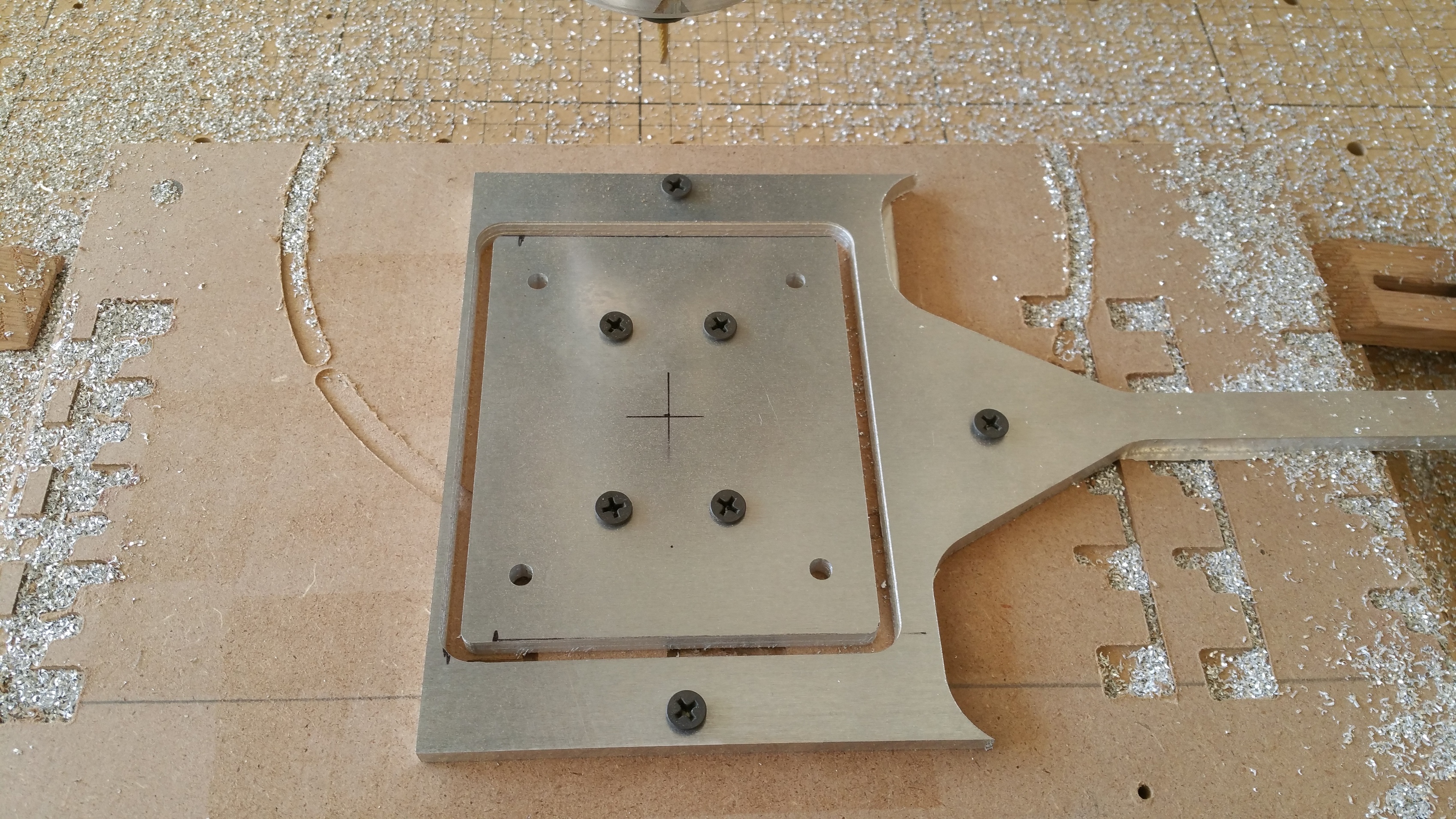

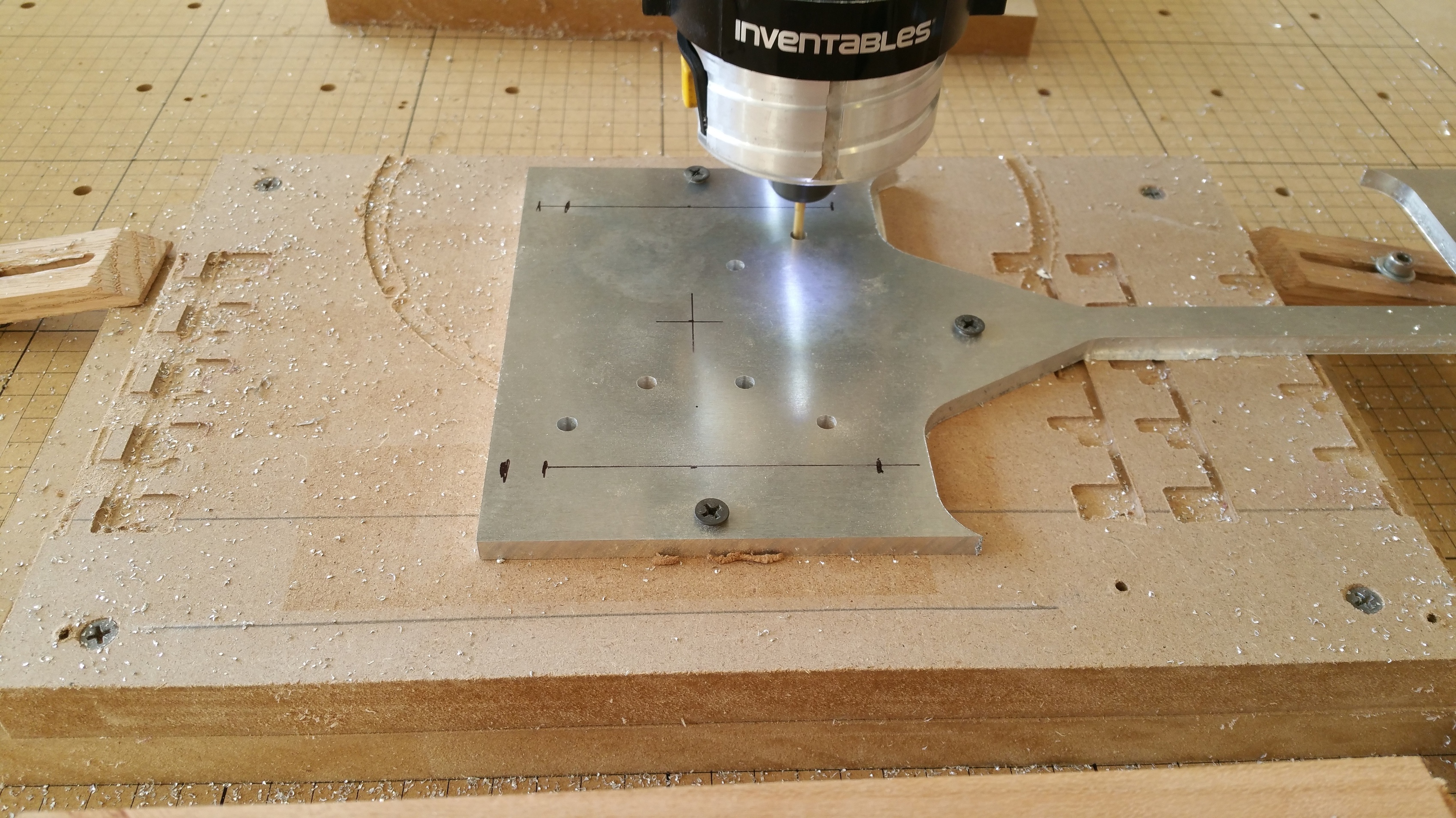

Started my Z-Axis upgrade this morning. I began by making a new plate to mount the Dewalt mount to the new assembly.
I cut with a 1/8" titanium nitride coated single flute upcut bit at:
depth of cut: 0.02"
feedrate: 45 IPM
plunge: 20 IPM
A test fit with the original spindle mount as it has the same hole alignment and spacing (never used…had to find the box it was in). Perfect fit.
