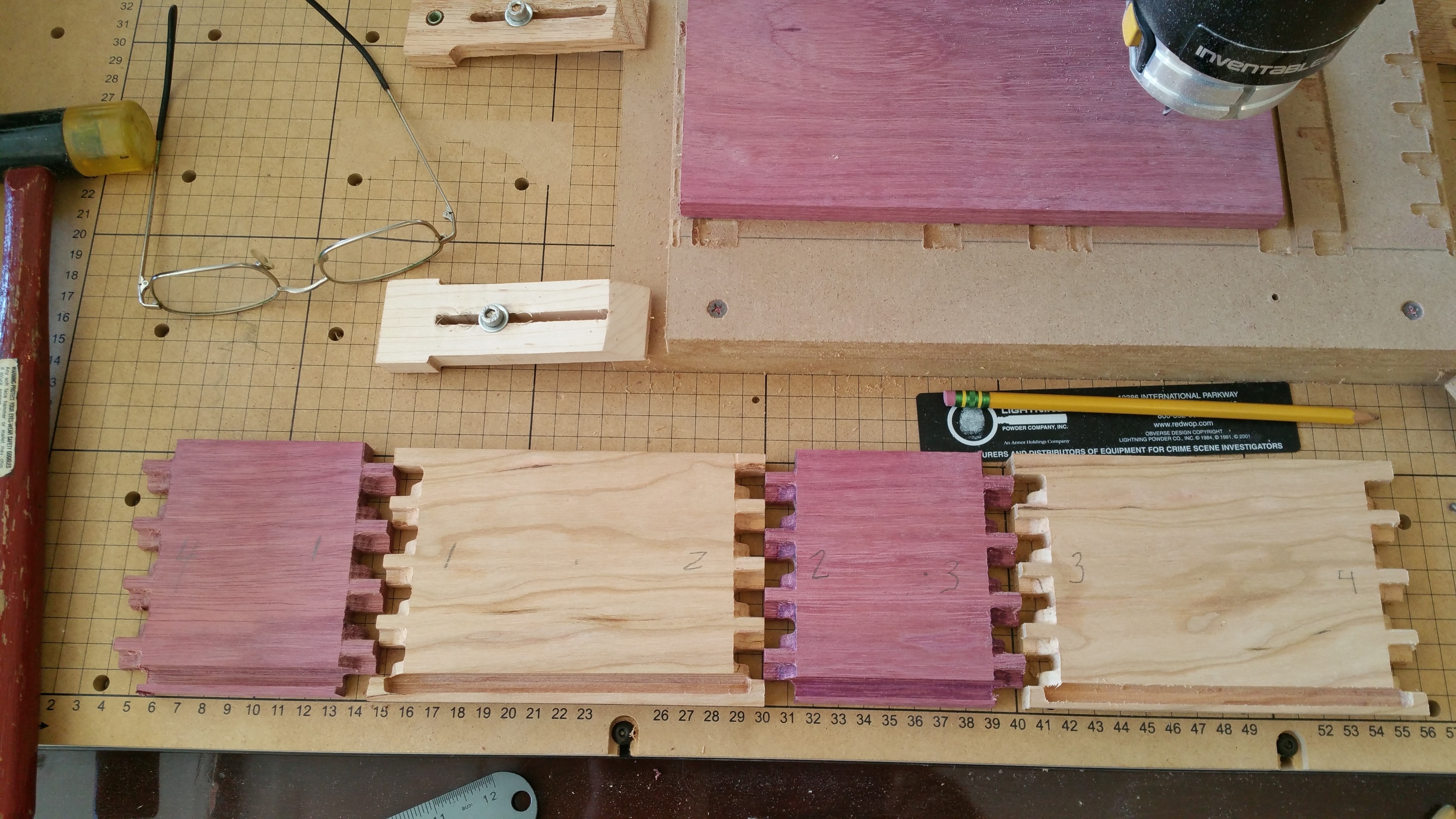

I used the fingermaker program again this morning to cut the pieces to make a couple of small 6" x 4" boxes out of maple and purpleheart. Still need to clean them up a bit.
It’s a little snug, but after I clean it up it will be a good fit.
I need to play with the glue gap setting in fingermaker. That should make them an easier fit.
I’m about to start using that myself, so do let us know what settings work out for you.
If you figure it out, I would LOVE a tutorial for Fingermaker. I’ve downloaded the demo and it looks SUPER cool, but it’s interface is daunting.
