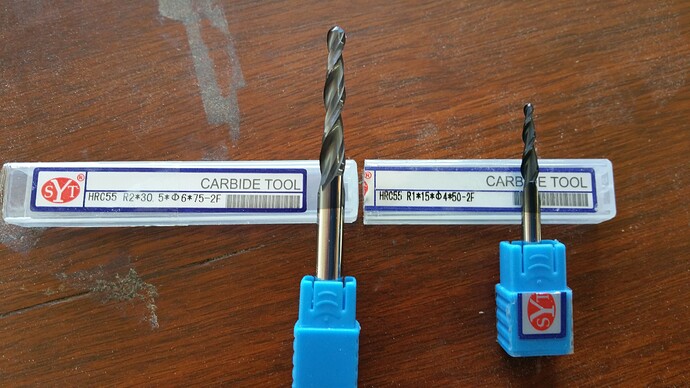

Finally picked up some bits to try out my 4mm and 6mm collets. Two tapered ball nose bit. Fresh from Ebay and China.

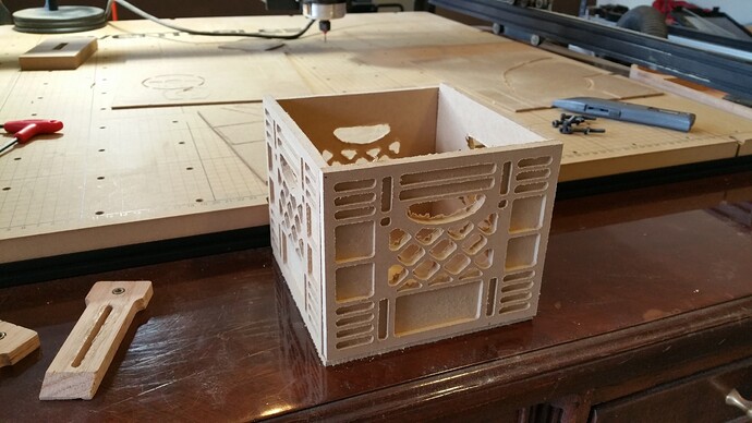

Made a mini milk crate out of 1/4" MDF. I still have to clean up, sand and add a 45 degree angle to the back of the sides to glue it up.
Love that mini crate!
how about posting the files for the crate?
Gladly, I made them in V-Carve, what program do you use?
If your posting, please post the CRV file also
Here is the V-Carve file, It has 2 layers, the side and the base. You will need to cut 4 sides and 1 base. I have tabs set for the holes that go all the way through. I would remove them, too much of a cleanup hassle…just let the little scrap fly :-). There is also nothing in the file that does the 45 degree cut on the back of the side pieces (miter cut) for assembly. I just used my table saw to do the miter on the sides…it was fast. You could flip the sides and use a 90 degree v-bit to cut the miter…too much work…lol
