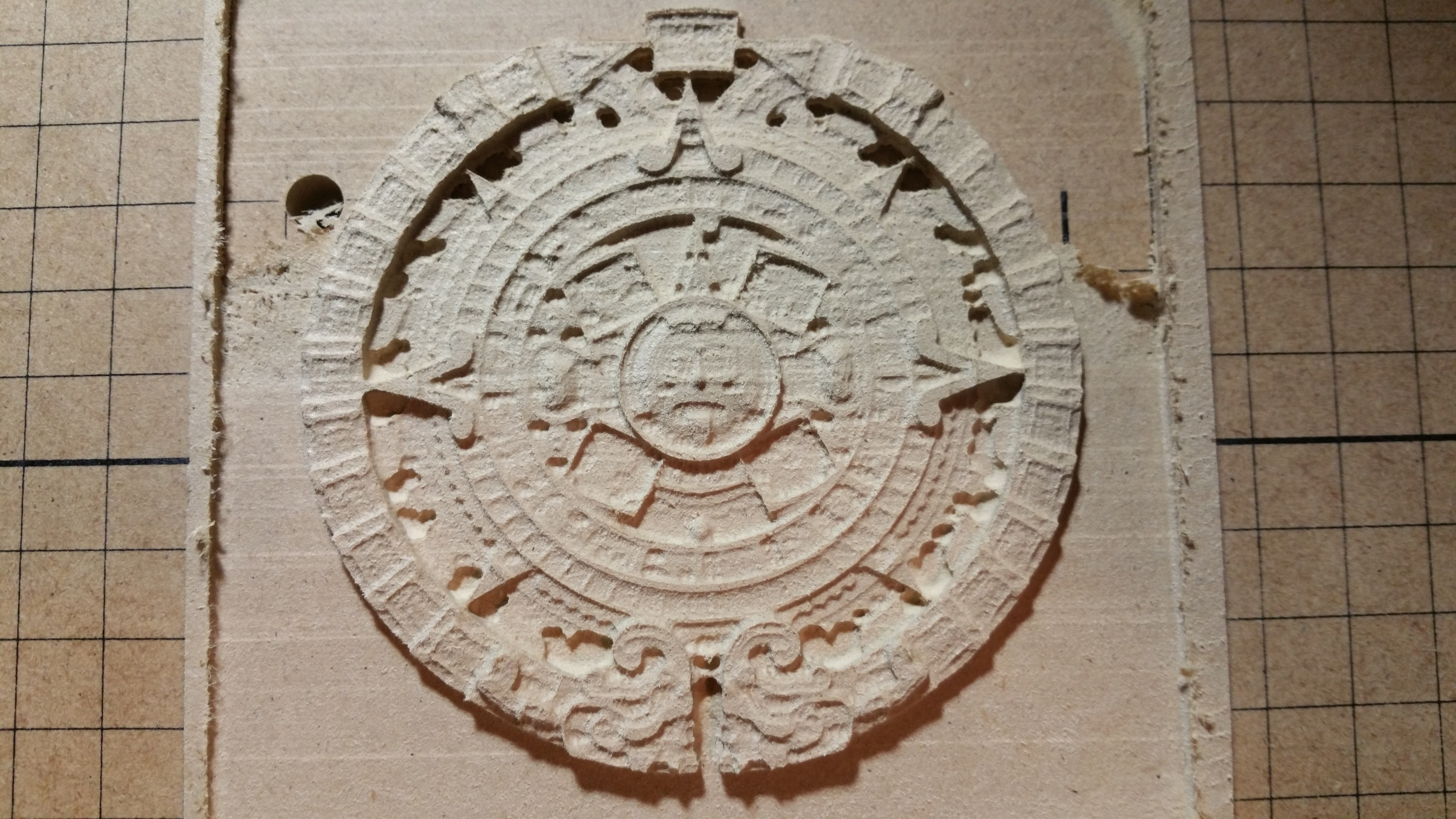

Here is a 3.5" Aztec Sunstone…This is just a test in MDF, I used a 1/4" endmill for a roughing pass at 100ipm and 50 plunge, followed that up with a 1/16" ballnose ate 100ipm and 50 plunge. I was going to do a third pass with a 20 degree v-bit, but decided not to. I plan to make a larger one and use it as an inlay piece on the top of a cherry box. @AllenMassey I might use the corian/candlewhite. Thanks for the idea.
I can’t wait to see the result.
Spectacular! How long did it take to carve?
The roughing pass was 15 minutes, the ballnose pass was 2 hours, the v-bit pass, which I didn’t do would have taken another hour.
