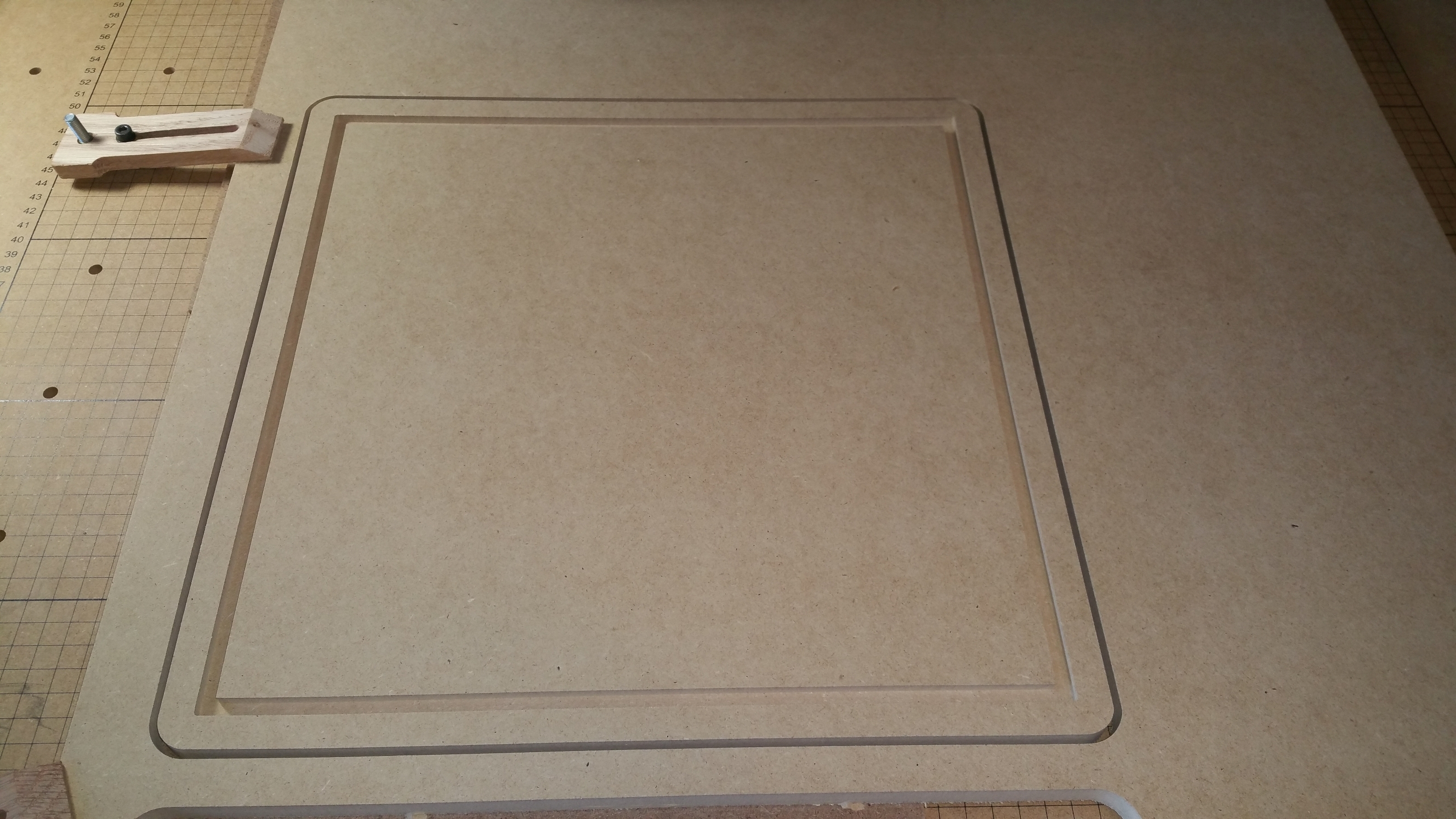

Time to clean up my wiring…Started cutting the new enclosure…the top and bottom will be of 1/2" MDF and the sides will be 1/4" MDF. Here is the top and bottom cut. The holes on the top are for air flow, there will be additional holes on the enclosure sides. More to follow, including the connectors I have for the stepper motors, limit switches (yes real limit switches), and the probe. Great idea from @Zach_Kaplan, so I will be adding Feed Hold, Cycle Start and Reset buttons as well as an E-Stop button mounted.
