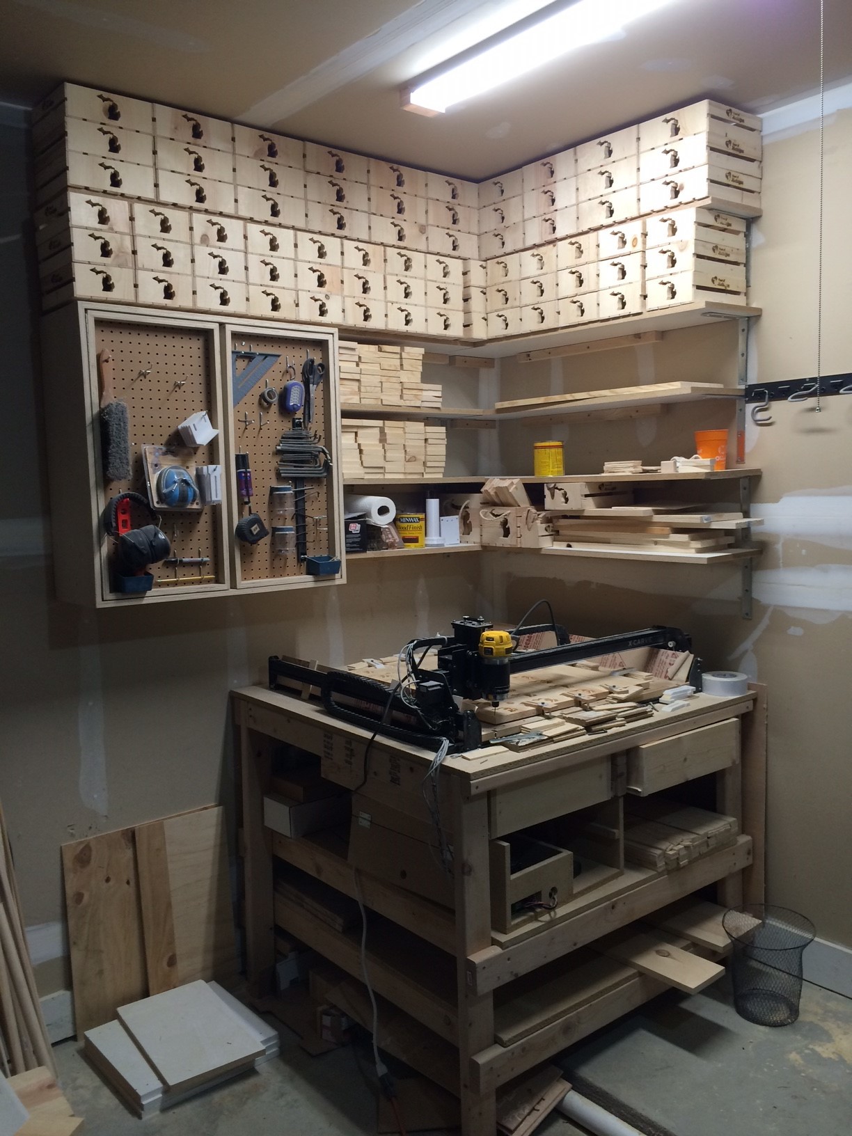

With the help of some networking I came across a company who sells local items and Michigan-made products and was looking for a new supplier for some of their items, specifically wooden crates with the state outline cutout on either end. I was lucky enough to know I would have some steady orders which helped my decision to pull the trigger on buying the machine, but have since optimized our workflow and have a good process. They have ordered close to 1,000 crates in the past year which has paid off my machine and the majority of the other tools in our “shop”.
For carving I am able to stack three 1x10 pine boards next to each other for the larger size and four 1x8 boards for the smaller version. I spaced out the outlines so once carved I can cut them down to length on the table saw and have them ready for assembly.
While I did purchase the fully loaded machine, I haven’t done any upgrades to date. I keep telling myself that I will once I make the time, but you know how that goes. I just thought someone might like to see how to make the base X-Carve profitable in a less complex way than perhaps assumed. This is an incredible community and I’m excited to get started on some of the projects on my ever-growing list.
