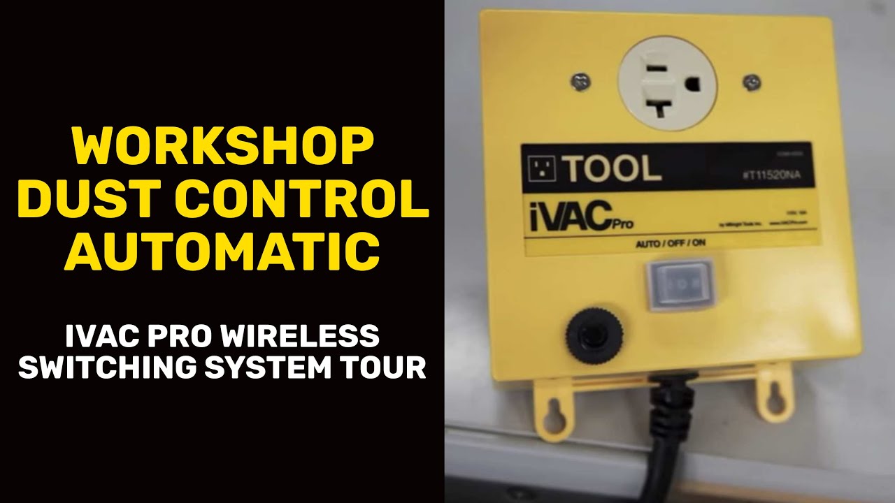

This one is another professional option if you are really that lazy.
