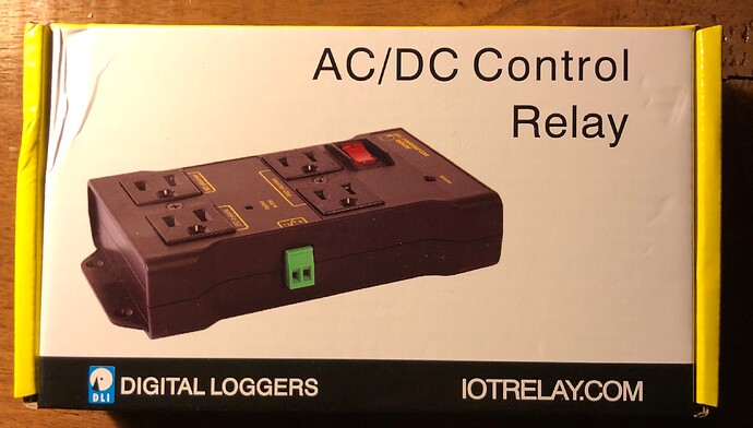

I bought this unit and it had no instructions. If anyone is using the same unit to shut off the spindle and your dust collection when the project is finished, how did you wire it to the X controller? Thank you for any help!
I have that and am using it to run my Router but not my dust collection.
The green terminals on the side control the power to the spindle.
Are you using the X-Controller?
I already had this for the rest of the shop.
Sorry for the delay. For X-Controller, connect the green terminals on the side of the power controller to the spindle control terminal on the back of the X-Controller.
I don’t have the Gshield any more and never used it to control the spindle anyway. I am pretty sure there are headed pins that can do what you want.
