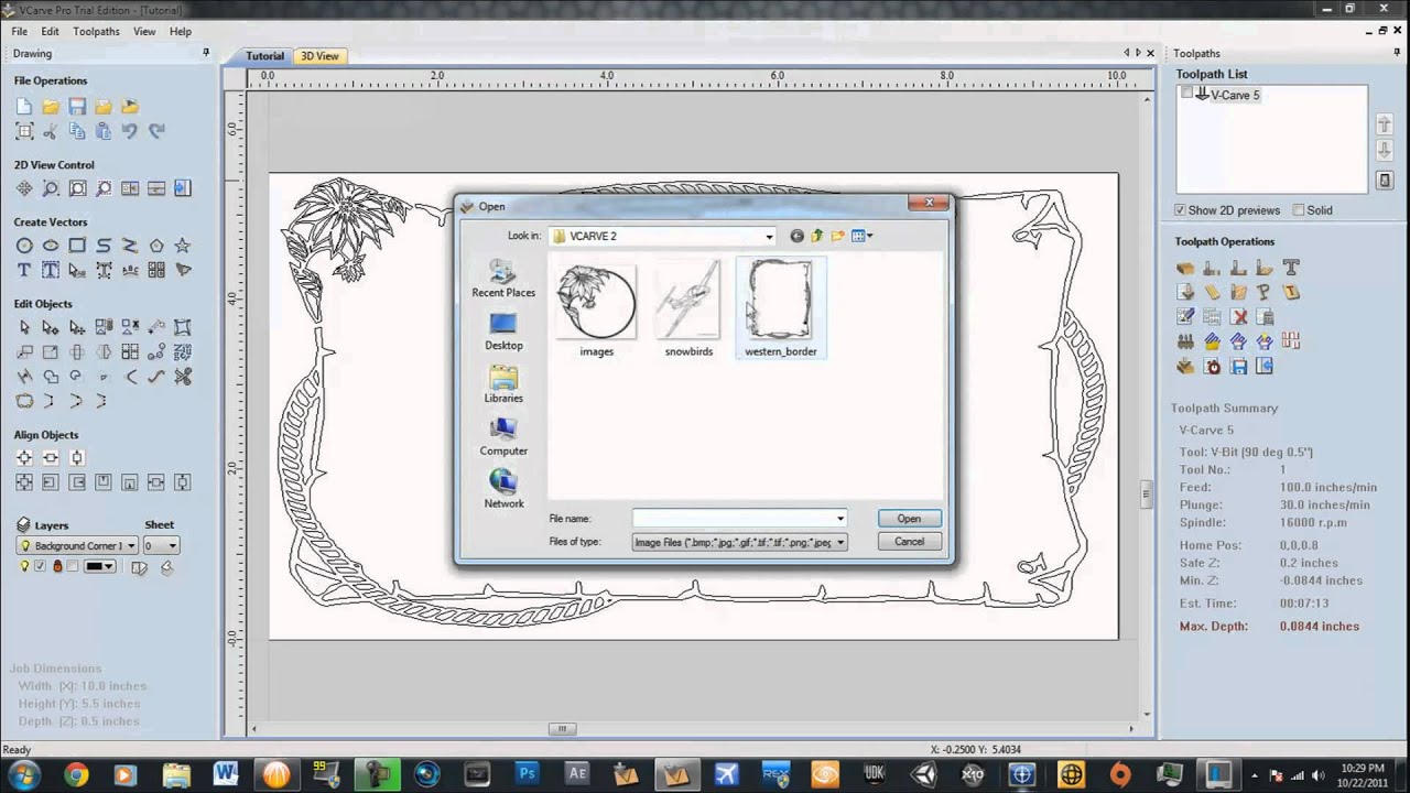

My Arduino is downloaded, my V-carve pro hard ware is setup, My universal g-code is downloaded. I need help. There must be a good tutorial video out there. I cannot find it. Need to get this going. New to this . Thanks Sam

Hey Zach, I have already made a couple things with easel. Just trying to get my v-carve pro working. How do I get my ardunio, v-carve pro and universal g code sender to talk to eachother and run. All of them are now on my computer but how do I link them up. I am alittle frustrated. Please help. Thanks Samuel Gilles.
Read this thread and see if it helps:
@SamuelGilles I just enabled gcode sending for you in Easel. You can send gcode created in VCarve pro from the file menu in Easel.
It will automatically handle all the connection issues. If you want to learn how to do it follow the post @larrym sent.

I have produced a few videos that may help. If you take a look at this one first:
It describes how you set things up to process VCarve Pro files. I have also shown a lot more VCarve Pro work in my later videos so check out my New Brit Workshop channel.

Great video - thanks it got me started.
Few videos out there. My favorite way to use the XC is to design on Sketch-up. Send to to V-carve (drag and drop). Create the gcode and use chillipeppr as my sender. Been doing this since last summer with little to no problems.
