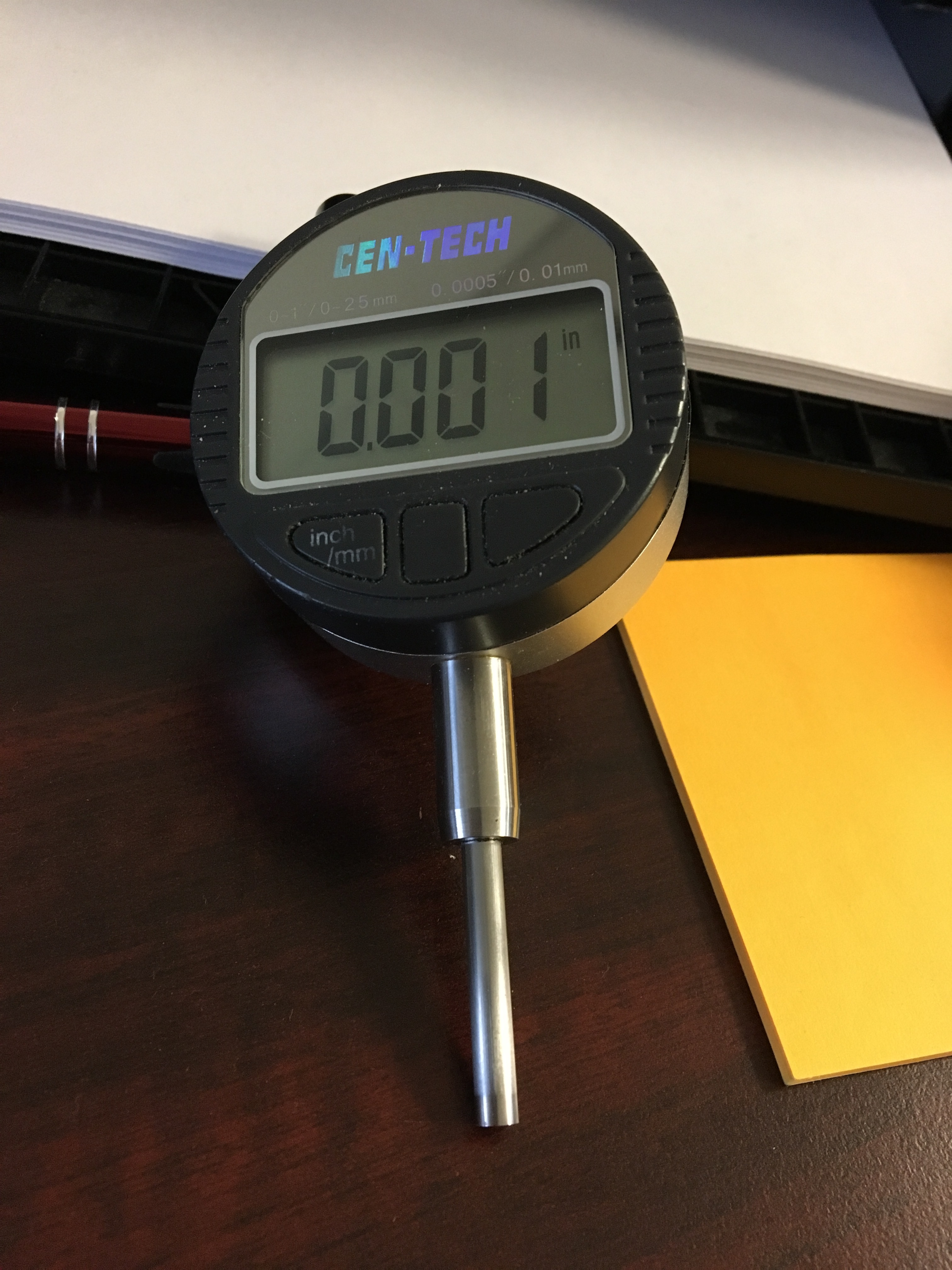

I set 102 t0 334.450 and cut exactly the depth of the material
I use this tool to measure my x,y,z axes and changes in the program
It is very useful tools and great
