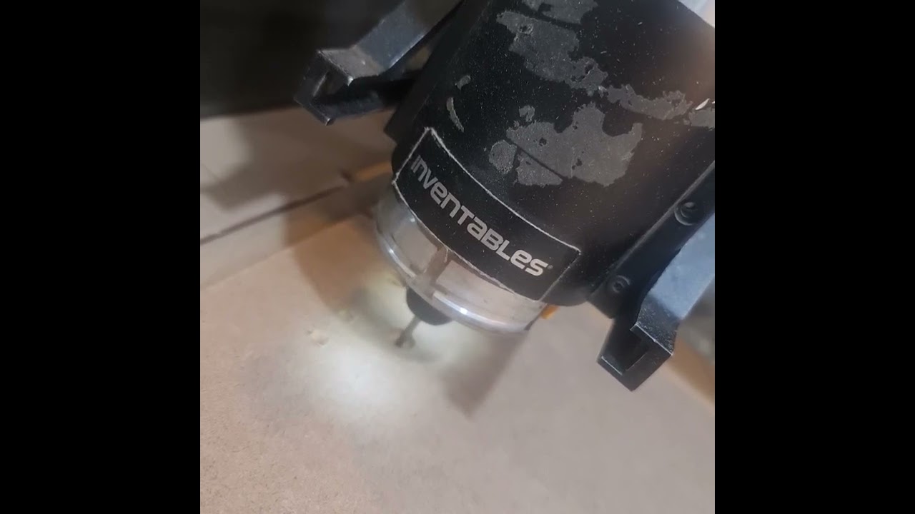

Hi
I’m having a problem with making a project as it is in the link
Easel - Untitled
At the beginning of the work, the spindle makes the first hole in the correct way and performs its work. When moving to the second hole, here is the problem, as the spindle moves to the required place, which is 5 cm, but the drilling is not carried out along. Rather, the operation is done above the site approximately 2 cm and gradually descends, as well as the third operation, which forces me If I do the surgery, I don’t know why
I also redefined and programmed the device as new, as well as to no avail
May I know the possible causes?
It’s the depth of the original hole correct?
Is the Z motor shaft coupler loose? Loose set screw?
If you jog your Z up 100mm and then back down 100mm, do you end up at the starting point?

Yes, dear, I tried in various ways to no avail, and I still haven’t even deleted a line and ran.
Yes
No …
Because in every process it performs correctly and when moving it goes wrong
No
