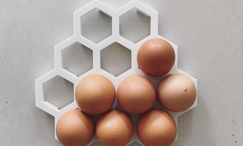

My wife has asked me to make some egg trays for family but I am struggling to come up with a good way to do this - especially how to get egg shaped holes in a bit of wood.
Can someone please suggest a route to do this?

Here is one approach
If you want contours, you’ll need to use some 3D software to create the contours and then 3D carve them with a ball end.
The one that Zach posted would just require a cutout with a size smaller than the egg so it holds it up. It’s a different take than the traditional egg tray.
If you don’t have any CAD experience you could try Tinkercad and then use Kiri Moto or Meshmixer to make the gcode. Then you could import the gcode into Easel.

Thanks guys, I was kind of hoping I could do a roughing cut stepped at decreasing radii and then a smoothing cut with a ball end cutter to smooth out the steps. I think I was naive in hoping that I could do a spiral cut to do the smoothing. I have seen and tried a fluting path in VCarve Pro which kind of worked but put a lot of strain on the bit as it was cutting all the way down in one pass - ouch!

You can manipulate the dome shapes included in Vcarve to get the effect you want. Then do a 3D roughing then a 3D finishing pass.
Couldn’t you model an egg-shaped contour in gray scale, then arrange the array and cutout with tabs and generate gcode from that?

This is a good idea of what I am trying to achieve.

anywhoo I mean basically I would start out with a solid rectangle the size of the entire part and then sketch the hole grid pattern on top
once I have that I would create a sphere with the same radius as the contoured pockets and place them over each hole in the grid
then lower the spheres to the proper depth into the solid rectangle and then use them as cutting tools to cut the pockets in the rectangle
then I would export out of fusion as stl and import into v-carve and set up all your toolpaths
