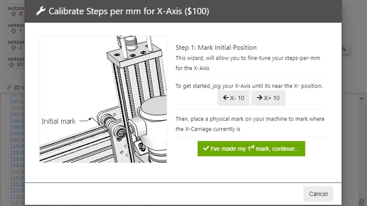

If you’re using OpenBuilds Control as the gcode sender, there is also a walkthough on that calibration (specifically for the workbee) with photos and blanks to enter your data, it does all the math for you…
Thanks Seth, I’ll try and find it, appreciate the help
In openbuilds control its under the wizard button at the main screen ![]()
