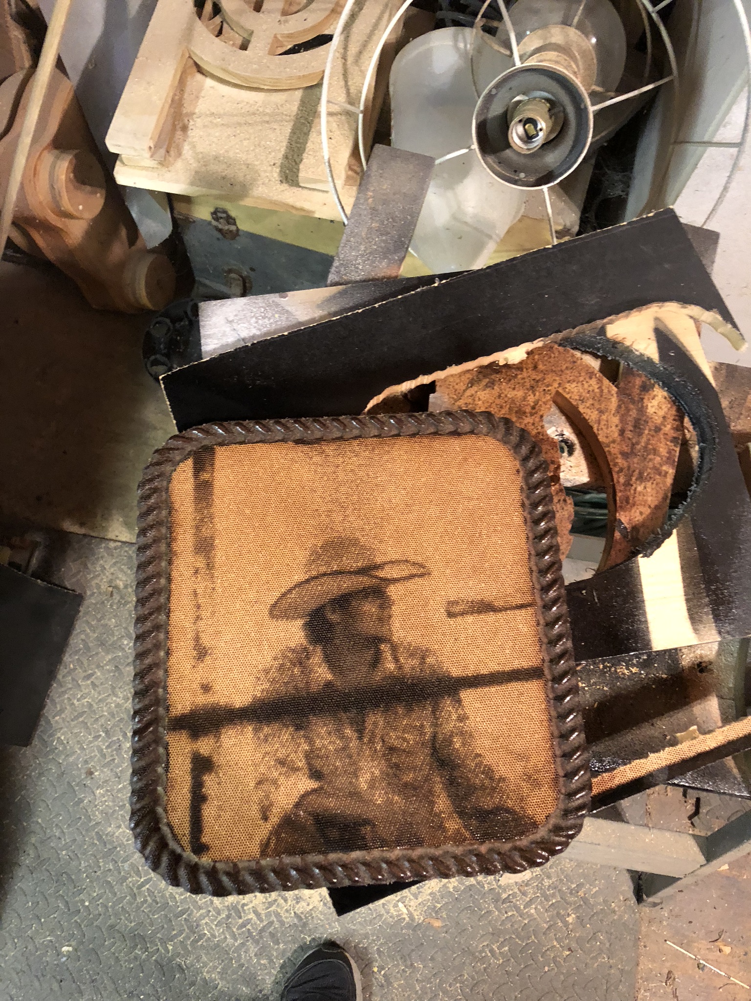

Finally got around to trying this great software. Pic of my oldest.
How long did that take?
The pic was about 10" X 12" and took over 8 hrs using a 45Deg 1/8 dia. Vbit. Think I could have optimized settings better and cut down on the time some. Add in another hour for the rope border and it was a long carve…the longest I have done so far.

If you use it in “Lines” mode it takes much less time, because there are no retracts. You can do “Dots” mode halftones in decent time, but you need a pretty fast Z. This was mine:
