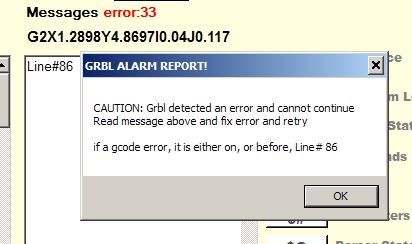

I have been carving some clipart and I am getting a GRBL error I can carve the roughing toolpath 1.54 hours and the finishing toolpath 1.26 hours both without any problem, but the profile stops after 1 minute
the error is ( caution GRBL detected an error if a G code error it is on or before line 81)
I have run this file several times without any problems, and I have had this same error on different files lately
I have just upgraded from V carve pro to Aspire, has that anything to do with the problem

Neil, thank you for trying help, I am using Picsender and this is the pop-up error, it says read message above but there is no message [image]

Sometimes reported errors are due to USB communication issues. If you can upload the entire file, I can check it out.
Patrick,
First, your code snippet does not produce an error here.
Second, I purposely changed the last line to generate an error, and this is what displays. The error number is in the message above the error box in red text.
What does your error report?
What PicSender version are you using?
Since VCarve 10.5 is being widely reported as having the same problem with arcs in grbl due to a change in the post processor, I wonder if Aspire has the same problem?
Hey @JohnChamplain, I’m glad to see that pic sender does, in fact, show the error number.
It does.
John
the version of Picsender I am using is 3.3.5 and the error code is 33, I did not see the error at first, my fault

I have not investigated the post processor issue, but others have reported that switching back to using the post processor from VCarve ver 10.0 works for them.

For anyone having problems with VCarve 10.5 and error 33 (G2/G3 arc gcodes), I have posted the file locations for the post processors on my computer. I recommend copying the older post processors from v10.0 or v9.5 VCarve versions to the My_PostP folder in v10.5 for testing. This way the v10.5 original post processors will not be disturbed. When you go to generate a gcode file, the only post processors you will have to chose from will be those you saved to the My_PostP folder.

this is the reply from Vectric
Many thanks for your inquiry.
I think that it might be the case that your particular configuration has problems running arc moves.
Could I please ask you to download install and select the attached post processor
to see if this resolves your problem.
Please find the attached post processor (link below).
Please copy the file to the “PostP” folder of VCarve Pro.
Thank’s John
I did get a reply from Vectric before I read your post, telling me the same thing, the sent me a link to a post-processor, I am not sure which version it is from but I put it in my post-processor, and it is the only one in there now, it is working fine at the moment, it is X-carve inch (*gcode), do I need to put X-Carve_mm.pp in there as well in case I do any work in millimetres
