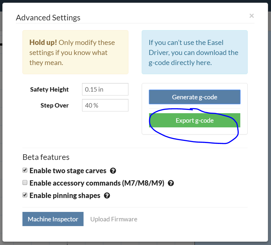

If you want to “simulate” what you’ve created in Easel you can download and use a program called CAMotics.
First, in Easel, you export a G-Code file of your work. You can find the export function under MACHINE > ADVANCED.
Then GENERATE G-CODE.
Then EXPORT G-CODE
That’ll save out a .nc file of your work.
Second, in CAMotics, open the .nc file you saved out from Easel.
Then, you should see a preview of your work. Then you just hit the PLAY button and watch it cut! =)
You can speed the cut up, slow it down, and turn items on and off. Fun stuff.
Enjoy!

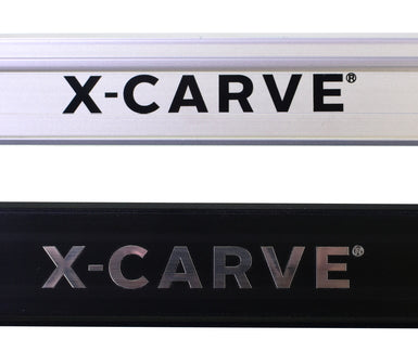

They do sell the sticker. I’ll see if I can find a link for you.

We do sell the sticker @philjohnson
