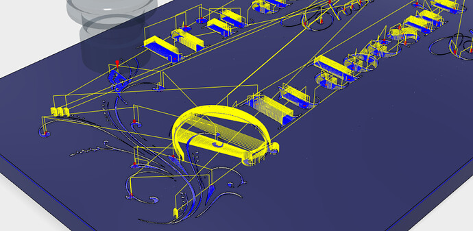

Does this look right? It says 15 or 17 hours, I’m guessing that is due to the tool that I used, 1/16" endmill aluminum.
2D Adaptive Clearing. How would I go about reducing the pickups?
I think there is an option in the linking tab for keeping tool down.
I usually use adaptive clearing with a larger bit, as I believe it’s meant to be used as a roughing operation.

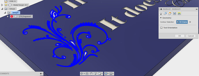

So I’ve reworked this a few times, this time with just the butterfly and lines, there are areas that I circled in red that when selected will select an entire plane on the piece and create some odd lines and movements. The whole image was extruded/cut in one operation so I’m confused as to why individual bottom surfaces are reacting differently.
You can toggle your selection style by either holding ctrl or alt or cmd, I’m not sure which one it is exactly, but that might help when selecting the contours.
