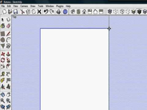

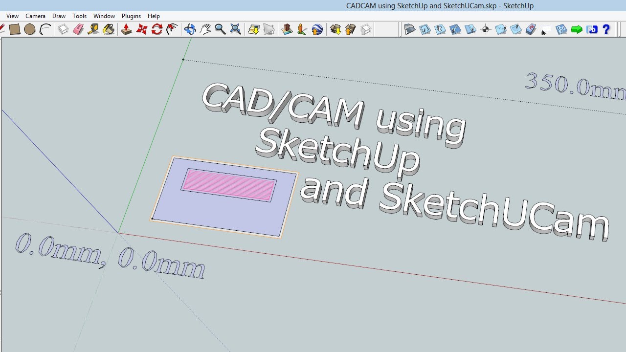

“SketchUCam is a free plugin written for the Google/Trimble SketchUp CAD program that allows the creation of Gcode to control your cnc machines and bring your SketchUp creations into the real world!” - from readme
This plugin allows you to export g-code directly from SketchUp. Here’s a few youtube intro to the plugin:
