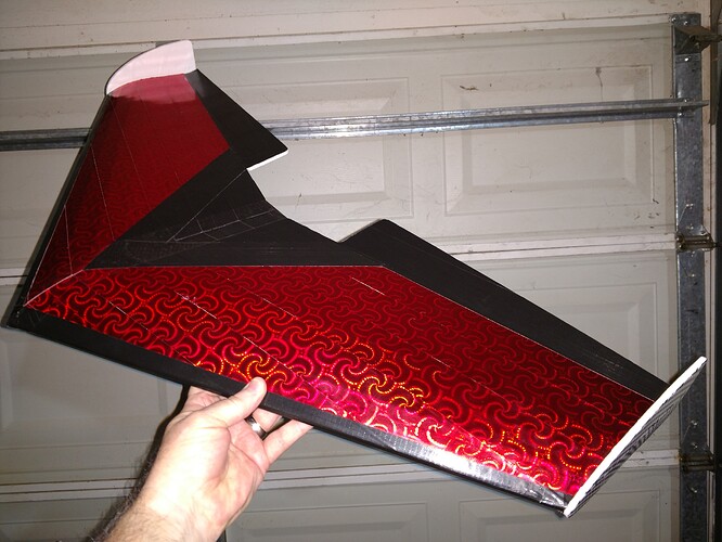

This may be a little late, but I have cut about 30 entire RC planes from Adams 5 mm foam board.
1/32 upcut
Feed, 4000 mm
Plunge, 4000 mm
Depth, 5.2 mm
Dewalt 611 at about 2. (Don’t know rpm)
The bottom of the cut is clean. The top is a bit fuzzy, and can easily be sanded.
Latest plane:
