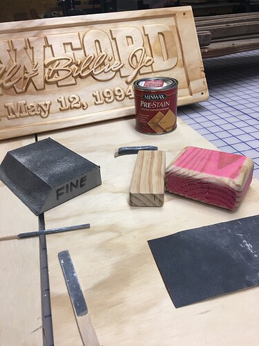

I wanted to try the multi layer carve, Easel did take a long time going back and forth. This picture was taken when I got done, no sanding. It’s 7.25 X 24”. I will cut it down to 22”. It took 4 hours, 1/4” 2 flute spiral bit and a 90 degree Diablo bit.

If you don’t mind me asking, what program did you use to create it?
I used CorelDraw to design it. Saved it as an SVG then imported it into Easel.
I sanded it last night and put on a coat of wood conditioner. I spent about 30 minutes sanding. I used some small pieces of wood and a sanding block from harbor freight, that sanding block worked great for getting into the small areas. Going to try some stain tonight.

did you use a pocket or vcarve toolpath on those letters?
I used a 1/4" bit for the rough pass and then a 90 degree for the detail
