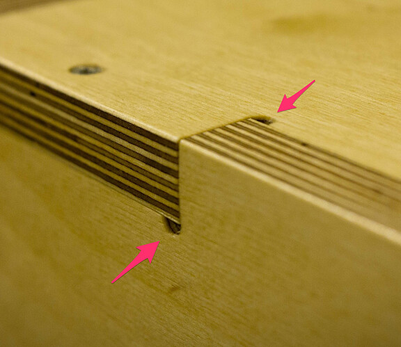

When you use a CNC to cut finger joints typically the design includes dog bones.
This might be a deal breaker for a fine furniture project. These are included because the CNC can’t produce tight right angles. You could probably do something without the dog bone, but you would need to do cleanup with a chisel.
