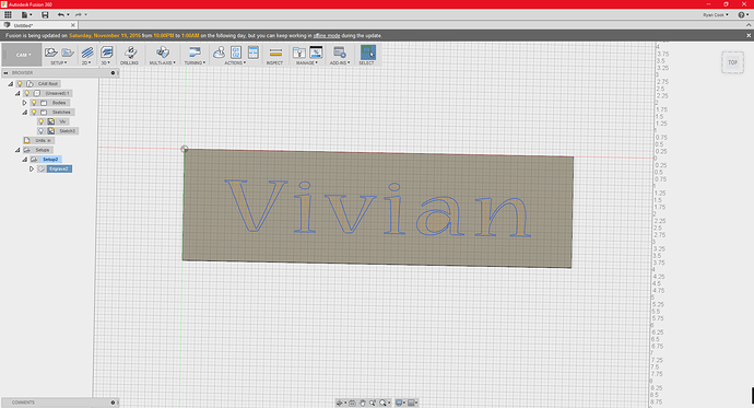

Having trouble with positioning on F-engrave. What’s the best way to set up a carve and have it centered? I have used the default origin with a bump stop and haven’t had much luck, tried jogging to get to a relative area but I’m not happy with the results. Also tried creating a dxf to preserve the dimensions but for some reason it doesn’t recgonize my dxf’s from illustrator. Been grasping at straws for the past few days over it and figured either @Scorch or @PhilJohnson could help me out?
This may be a dumb question but why can’t you use the “Mid-Center” origin option it will put the origin in the center your image?
Side Note: I would love to see a DXF from Illustrator that F-Engrave can’t open. Please e-mail a sample DXF file to the e-mail address in the F-Engrave help menu if you are willing.
My problem with using bottom corner is that it puts it to the bottom corner of the text, not the saved file.
Which I have to jog the machine to get it centered on the piece. My dilemma is that I am making doll beds for my nieces with their names carved into the foot board panels and have dadoed the surrounding frame 1/2". So I need this centered on the panel. This is what I was trying to go for in Fusion but thought F-Engrave would be better suited,
@Scorch. So fusion recognizes it but F-Engrave doesn’t. Am I having a sizing issue with the BMP? Could I add a very thin black stroke around the edge of the BMP so F-engrave sees it but won’t carve it to retain the dimensions? I’m just looking for a way to put the piece against my bump stop run G28 and zero then carve.
@RyanCook thanks for sending the DXF file (via e-mail). I was able to figure out why your DXF was not loading in F-Engrave. There was a bug in F-Engrave that prevented loading DXF files the contained no features with positive Y positions.
I have fixed the bug and released a new version (V1.61) on the F-Engrave web page. Now your DXF file will load with the coordinate system where you need it.

FYI -
Another way to shift the origin for the F-Engrave output is to change the “X Offset” and “Y Offset” in the F-Engrave “General Settings” window. There will be no visual indication within F-Engrave that these settings have been changed but the g-code output will have the origin offset by the values entered. So for anyone that does not have the ability to make a DXF file with the origin in the desired location the offsets can achieve the same effect.
