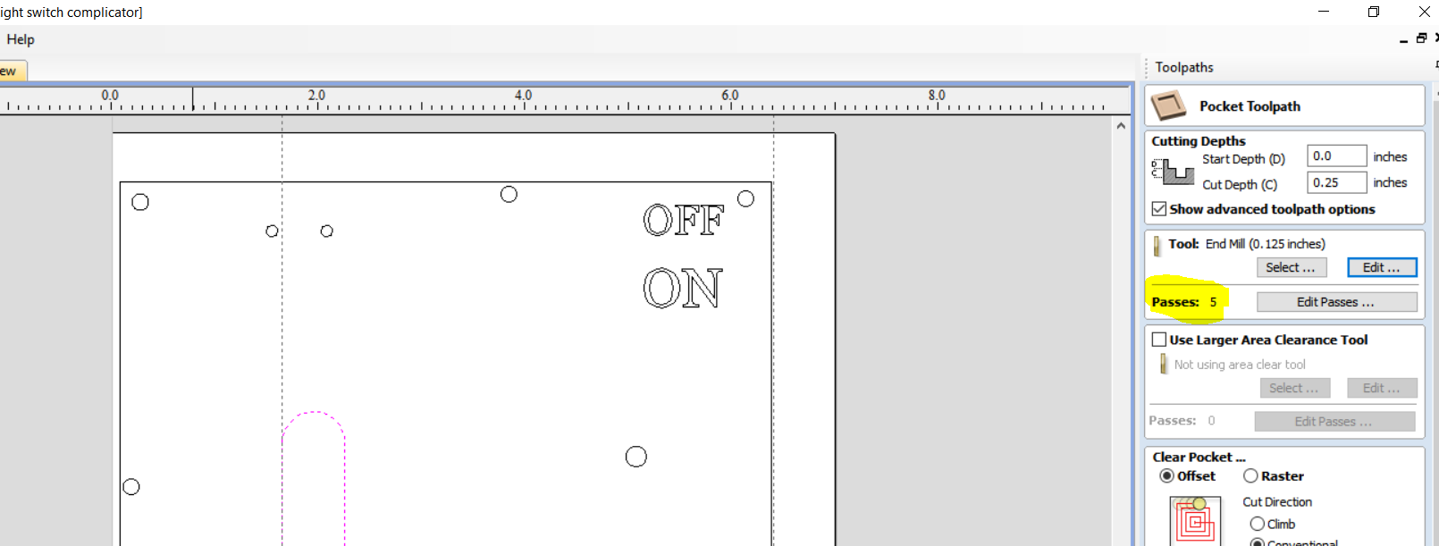

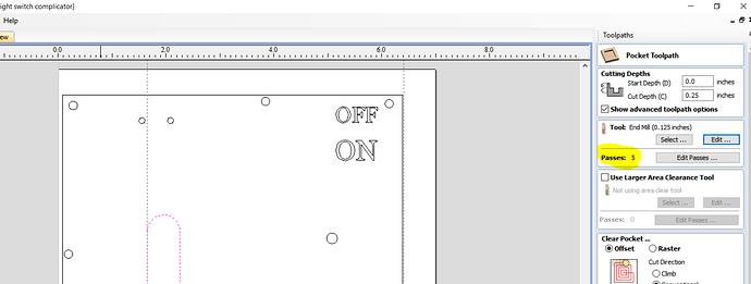

Here is a screen shot from Vcarve showing a profile cut though material that is .25 inches thick. I am using a .125 inch diameter endmill and the DOC is set to .06 for that tool. So Vcarve is telling me it will take 5 passes to cut through the material
You can override the DOC for each pass in Vcarve (if you want to) by clicking the “Edit Passes” button. Then you will see a complicated looking screen that lets you set the DOC for each pass to just adjust the total number of passes that you want. This is sometimes useful if the last pass is very small.
Typically you will define the DOC for each tool in your Vcarve tool library and then just leave it alone.
Here I have the pass depth set to 0.07 for this particular bit.
