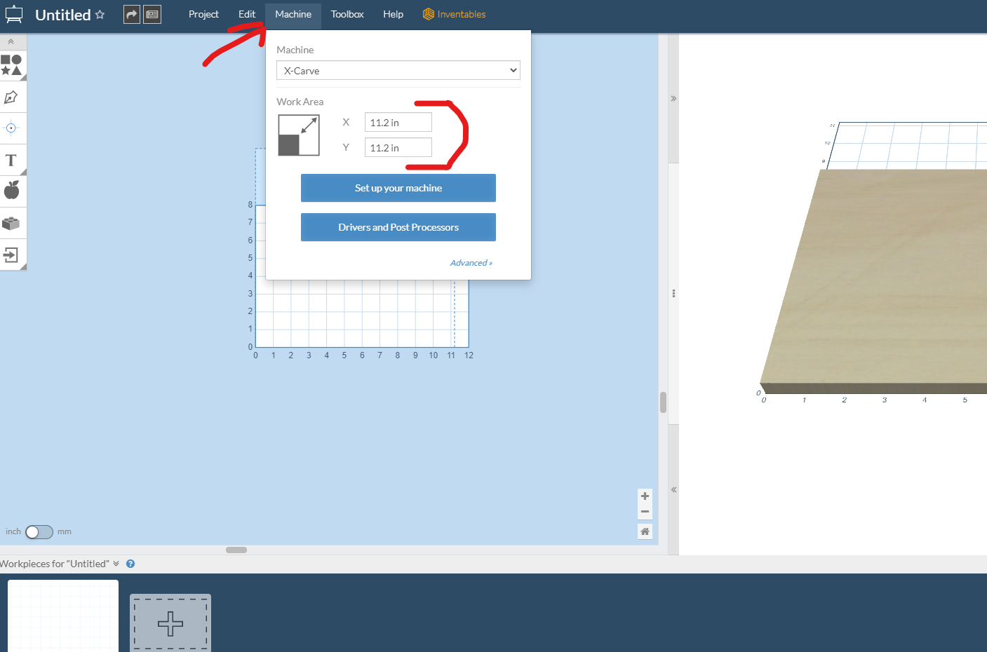

I hate to be always asking questions and being a pain, but I still have a couple of questions. 1. When I go to setup my machine and it asks how many rails, what should be my answer? Does it have anything to do with the extension I bought for the table?
2. Do I have to run through this machine setup procedure each time I start a new project? I will try my best to not ask stupid questions.

Not sure what extension you mean, what cnc is this?
Also the machine dimensions can be edited after that setup by going to Machine at the top
The machine setup is stored in the browser cache, if your having to constantly do it then your cache is getting cleared. Usually this is either browser privacy setting or anti-virus software setting… get the cache to not clear itself and you won’t need to do it. Unless the browser gets an update or windows gets a large update, usually about 1 or 2 times per year…

I have the 3018 Pro and I bought the extension table to go with it. This allows me to have a work surface of 12"x14", instead of the 12"x7" work surface on the standard 3018 Pro. So my question is in the machine setup, does the rail size 500x500 change because of my work surface change? I really appreciate all the help you are giving me.
Thanks again
Dave
Well, the rail size selection in the machine setup is purely referential when you do the setup… if you had an X-Carve then the values would make sense and work properly… since your doing a 3018 (3040) you can choose any size in there but youll want to change it after setup by clicking “Machine” at the top bar.
So Just go here to change it after finishing the setup. ![]()
