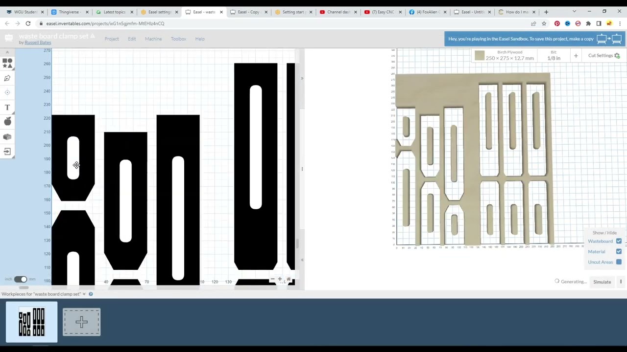

Oh also, can you share the easel project just so I can take a look at the design and make sure there are not anomalies off in space causing it to go off to that area outside the work area on purpose.
In Easel go to Project>Share then select “unlisted” and copy that link, then paste it over here.
Thanks!
. . . OR you can just open a new project and just toss in a basic square or circle to ensure there is no other accidental design bits off in space and re-try the carve & see if it wants to crash again

I found a few issues with the Clamp project, But none of them are related to the issue you’re reporting in this post. . BUT here’s how to fix them anyway ![]()
And here’s the file I ended up with at the end of that video.
