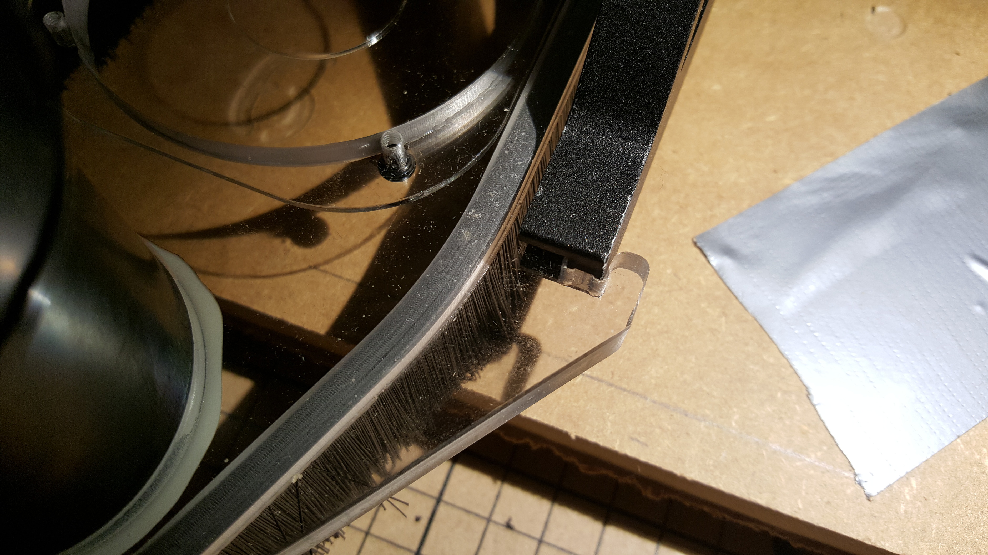

Sorry, I should have thought to include a picture in the original post! This picture shows that the centerline of the dust shoe cannot line up with the waste board zero point without crashing into the left front corner bracket. I would need about 30mm additional clearance. Any idea what might be causing this problem? Is my bed assembled incorrectly, perhaps?
I always remove my shoe and raise the left arm up for clearance during homing. I wind up needing the shoe removed to set the z,x, and y zeros anyway. I don’t think it’s meant to be left on during homing. Not unless you move the homing switch, reducing your cut area.
