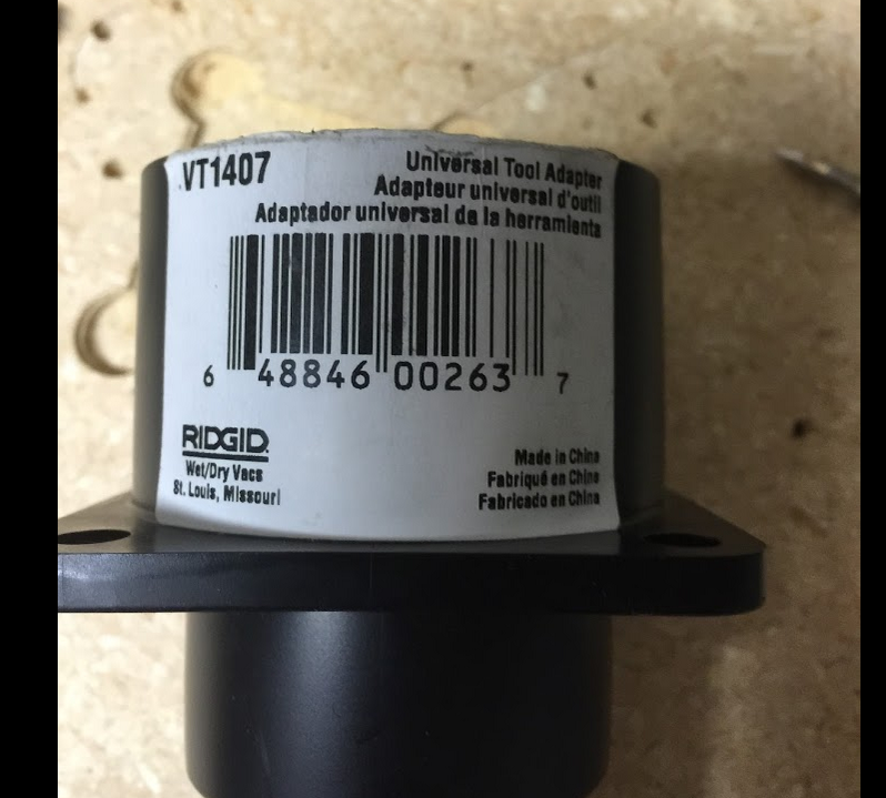

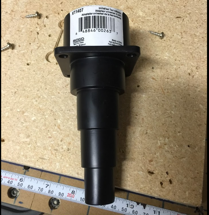

To attach the vacuum hose to the top plate of my dust shoe I decided to use this rubber adapter nozzle.
I cut the rubber nozzle leaving about an inch below the flange. I then bolted the flange to the top of the dust shoe. My 2.5 inch vacuum hose fits snug into the top of the adapter.
