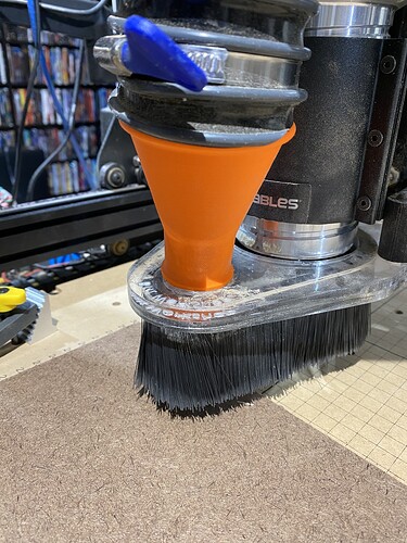

Ok, so for some reason whatever hoses I got for dust collection (using a variant of the “New Brit Workshop” design which originally was 3D printed but now in clear acrylic off my glowforge) I can’t get it to properly fit other hoses/nozzles and the dust deputy. Not sure why this stuff seems totally non-standardized. Anyway a quick trip through CAD and printed on my Prusa (figured orange PLA would help find them in that snarl. I addition I wanted to hang my mini-pc on the post of the monitor/keyboard arm that is where easel runs to do the carves (I don’t sit down there designing, but for a quick tuneup or running the job it’s awesome) in addition I hung a webcam (1/4-20 mount) underneath it with a another mount. Yeah that Y-Y connector looks sketchy but works really well, as I wanted dust collection to my table saw (Grey hose) and a general cleanup vacuum, the adapter into the dust shoe has barbs that hold it in place really well - that took some experimenting to get exactly right… the vacuum is controlled by the M7/M9 Gcode combo Via a relay.
I went all acrylic as I wanted more visibility. I’m thinking of some led strip in there. The 2 little lights on the 611 really don’t give a lot of light.
Greetings this was my first dust shoe that I see the problems with this type of shoe fixed to the router are several 1 it is difficult to change the bit 2 when you are going to cut the hairs they get pressure on occasions until separation I do not want to feel bad but those factors are
I mean sure it is certainly more awkward to change bits, but I use the precision collet and adapter which has a easier wrench, and also my shoe is much thinner than yours. As long as you raise the z-height high enough I haven’t found it to be a problem. And being made of acrylic I can see through it to align x-y. Not sure what you mean by cut the hairs. I never cut these at all (I cut the steel backing strip of course as it came 1m long) I have not had any hairs fall out. This stuff is extremely tough (I got this brush border from McMaster Carr). If it’s not fixed height then it grinds into the clamps, etc. I find it quite reliable. I do want to change to the CNC4NEWBIE z-axis so that will require a rethinking of the mounting, but I’m sure with calipers, CAD and some trial and error, I can solve that.
