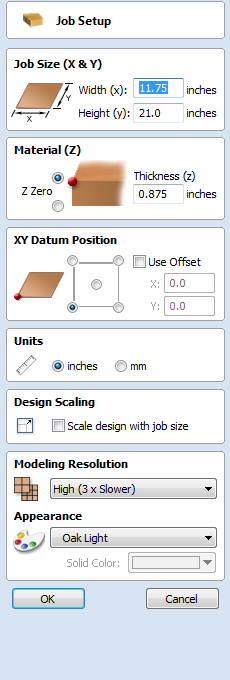

I need the specs on your tapered ball nose and v bit then I can generate the g code, and material dimensions and roughly what size you want it.

I’d love to glue up a couple of 6" boards I have to make a panel…but I don’t know what it is (pics here: Imgur: The magic of the Internet). Looking at that, ~9" wide x height would be fine. Material would be ~11.75 wide x L x 7/8"

here is the material settings I used there is a .0625 gap below the model so that the finish pass doesn’t cut all the way through, set the cutout depth at .875 so make sure your material isn’t thinner or you will get into your waste board
