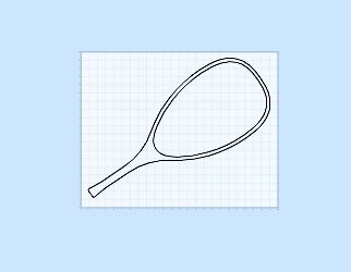

I cut out a landing net and it looks awesome. But, I noticed that the left side of the net was cut with a thinner wall than the right side. What might have been the cause of this?
Loose Vwheels & loose belt…or the project itself

Do you have any idea why it makes me choose 1/8 bit size for this cut? If I choose a smaller bit, my image disappears on the cutting surface in Easel. I have to choose 1/32 to make it work but I could obviously use 1/16 or 1/8 to cut this shape I feel.
Thanks!
Justin
After you tighten your machine, I would double check your cut setting.
make sure you’re cutting inside of your inner vector and outside of your outer vector profile cutout.
also, add some tab to hold your project together until complete.
How do I make sure I am cutting on these sides of the vector? I noticed on my last landing net project that the bit would make two passes, one just a little wider that the first to cut out a thicker line. I just need one line the size of the actual bit. Thanks so much for the help!
I will get this shared ASAP!
This is an iinidication that you’re design is setup as a solid line of the shape, which is actually 2 vector lines, instead of a single perimiter. I can show in a short video how to fix… using your project link would make the most sense ![]()

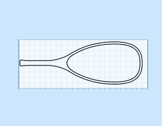

Here is another net I was doing that wouldn’t allow me to use the 1/8 bit. Sorry for all the replys.
yep, It’s shared correctly…

Holy smokes man! That was incredible! I can’t wait to get my next one off the table. Do you have any thoughts about the bit size?
1/8" is used like 80% of the time on my machine ![]()
but you’ll want to get the correct collet if you are using the adapter sleeves because they wear out and then the bit will fall out mid carve… But as far as 1/8" goes, its a winner for the price in my books
The only way I’ve been able to get the design to carve is to choose 1/32. Can I just choose 1/32 and just carve with the 1/8 that but that’s in my router? Or will the new tips you showed me allow me to choose 1/8 bit now?
Yes to this… Once it’s changed from “pocket” to “outside…” and/or “inside the path” then you’d select the bit you will actually use and the toolpath will be set appropriately… this would also explain the initial post of the thickness issue and this fix will make the thickness more accurate ![]()
