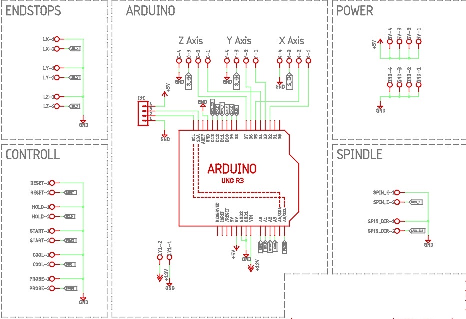

sale your controller for parts and MAKE YOU OWN WITH an Arduino.
- 1x Arduino Uno R3
- 4x TB6600 Drivers
- 1x 24VDC 15 Amp Power Supply (Mean Well or Similar Recommended)
- 6 Wire Ribbon Cable or Hookup Wire

The Demon shield made it a breeze to make my own controller.
