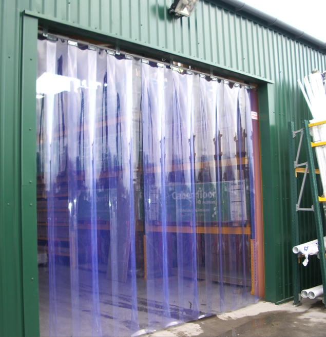

2mm fab foam is a bit too flexible I think for such a tall curtain. Maybe try the thicker plastic as used in the doorway curtains in factories. Only a mm or so thick, stiff but flexible and see through.

Vinyl door strip is exactly the stuff I used. Works great. I 3d printed a holder for it.
Sounds promising, I ordered 7 ft strip. Will be Monday Ship. Thanks.

I ordered Vinyl Door Strip as JohnPattillo’s idea. Let see how this perform. It is look a little softer, if it pushes spindle upward again, I will cut skirt pieces thinner or narrower I can say.
One thing sure, I can see the bit easier.

Update. It’s not as soft I was expecting. But better than Bristle brush I guess. I didn’t see any up force on this skirt.
