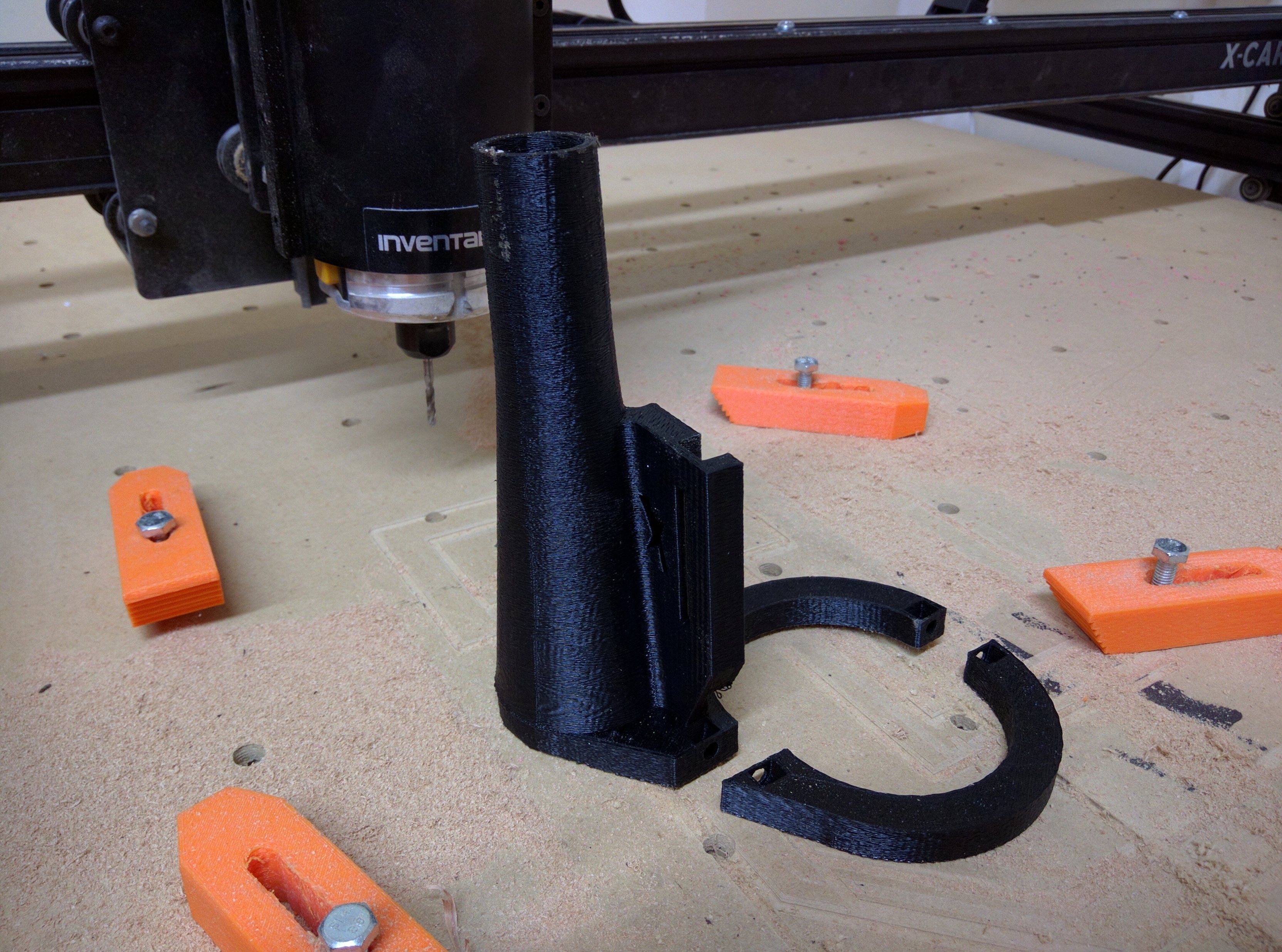

Everything fit. I had to use .3" magnets because we messed up the wall thickness on the print. Now to get some skirting materials and to actually bolt it up. Thankls Francesco
@EdShouse I’m about ready to print mine but have a quick Q: can you still access the button to change bits?
Air-diversion question here: I note in most of these designs folks are blowing the air out/up, is there are reason we don’t blow it down outside of the skirt? That would seem to create a high-pressure field around the device forcing chips towards the center, where they can get sucked up into the vacuum. Any thoughts?

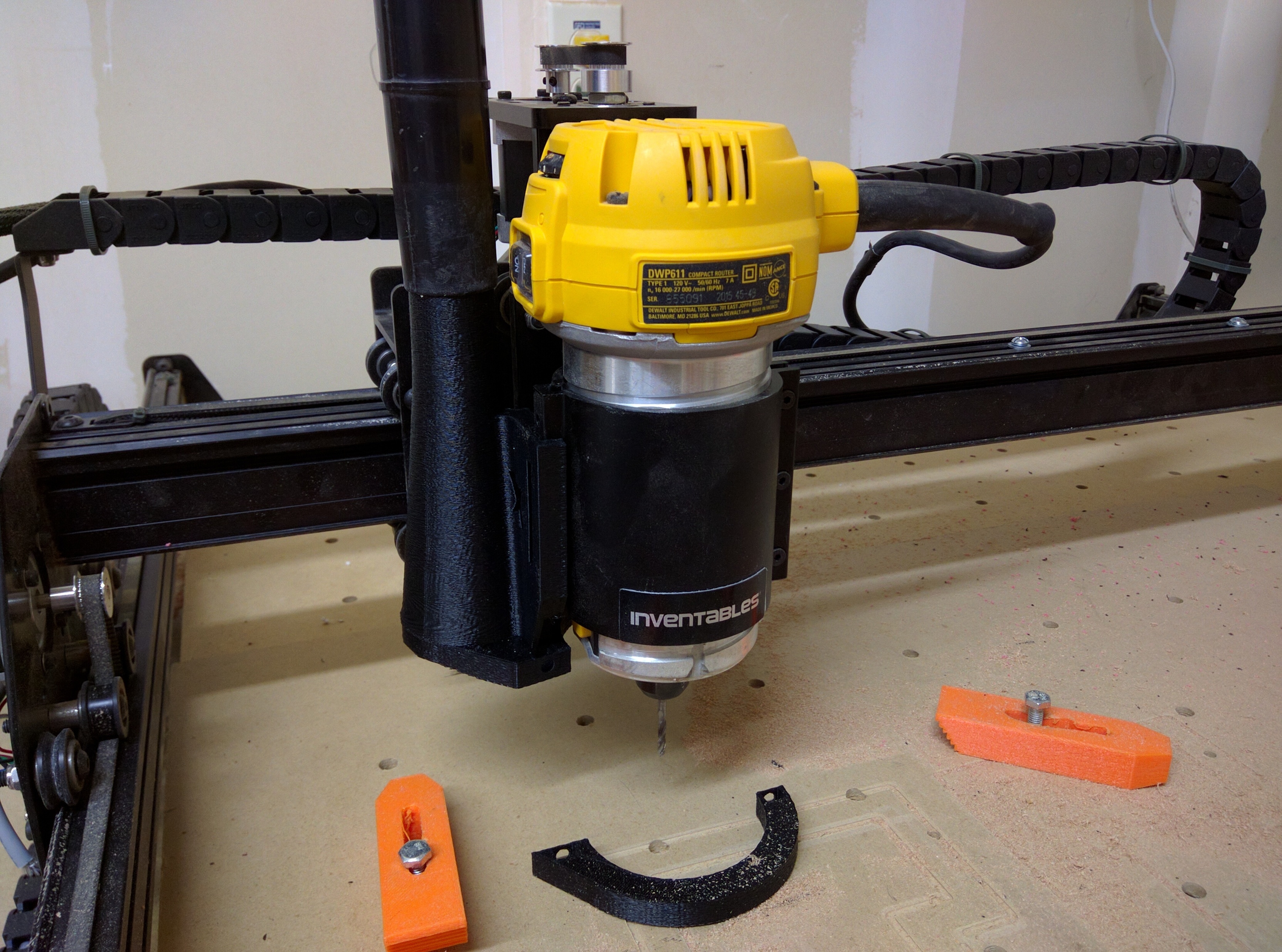

Sorry didnt grab a pic of that but yes you can just depends on how you align it. Here is a screen shot from a vid I took. Watching playoff games so to lazy to go out to the CNC right now to take a photo.

I think that everyone’s answer will vary. I personally went through 3 designs before I found one that I liked. They all worked but had advantages and disadvantages. The first 2 I made were some what rigid and I had to constantly had to worry about hitting the clamps. In my opinion one with a skirt is the way to go. I absolutely love the one I have now and have had zero problems with it in the 2 months I have been using it. There is a project for mine in the project section if you are interested in it.
Printed mine out this weekend… very lightweight and small.
Looks great, you may have to turn your router a little to reach push button easier.
I think you will attach with fly nut to slide it up and down.
Yup! that’s exactly what i did… turned the router a little and made it easier to slide the dust shoe up and down. I like it as high up and out of the way as possible so it doesn’t hit my (crappy) clamps…
