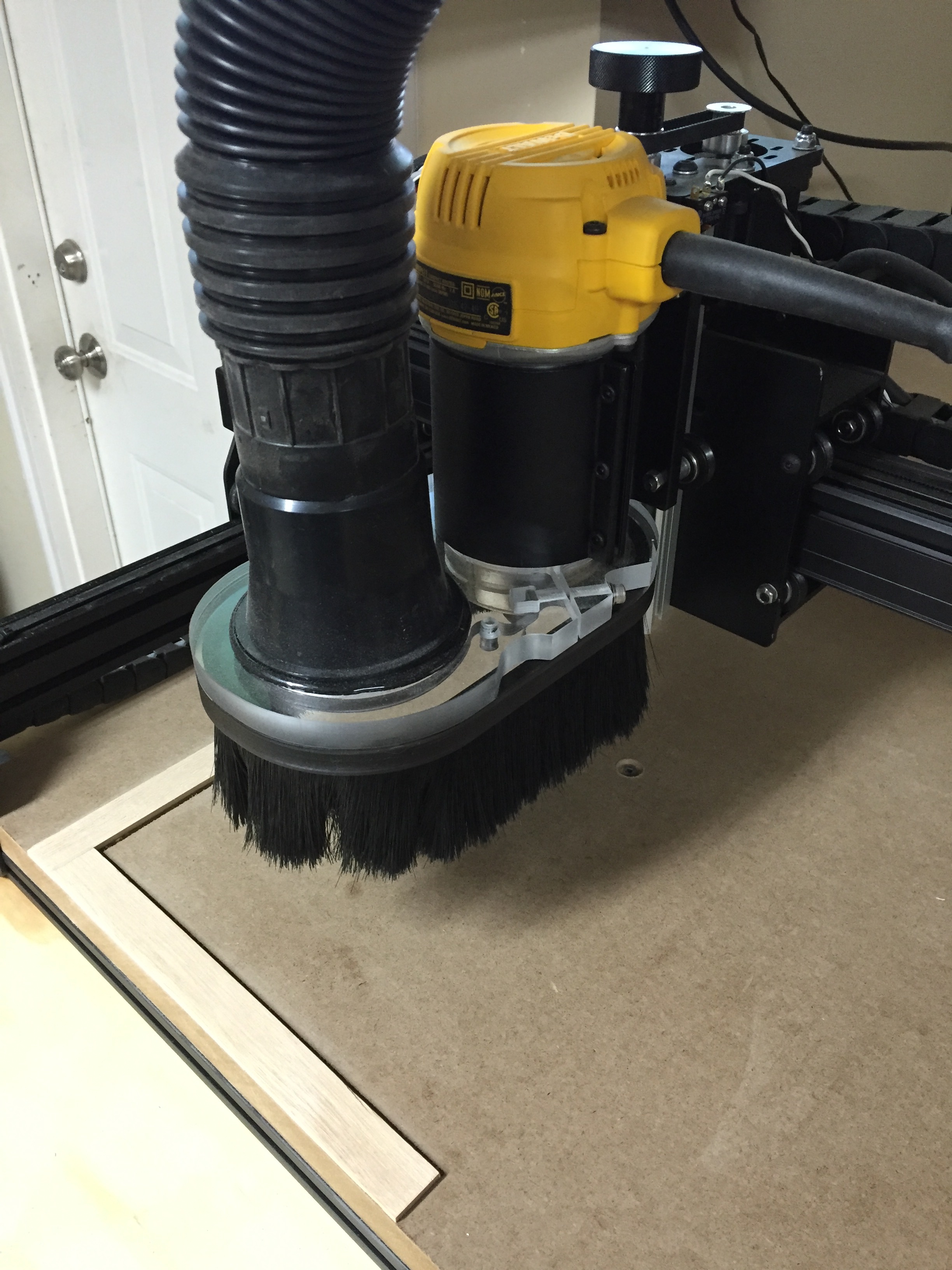

So I broke down and bought the Dewalt 611 dust shoe from Kent CNC and I must say that I am very happy with my purchase. Not only does it allow my shop vac to get almost all of the chips and dust but also looks very professional. Here is a picture of my complete setup and then a close up of the dust shoe.

How does that help with dust management?
You are more than welcome to your opinion. I however feel that was a great investment. I operate a small woodworking shop when Iâm not busy with my day job in the US Army. So for me it was well worth the money and I would recommend it to anyone wanting a good dust shoe option to purchase.
